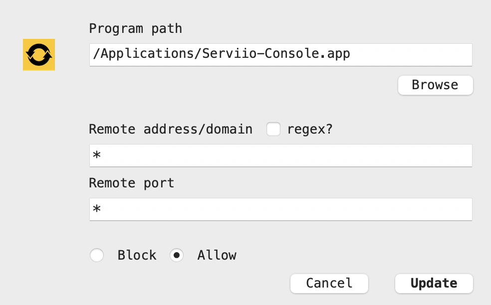

Hello everyone,
I start using LULU a firewall for Mac (i needed it ;-), but even if i allowed the connection my sumsung still didnt see serviio... unless i disable then enabled again LULU... so it works.
shuld i insert the port used by? if this the case what port serviio use?
whats is "remote addres/domain"... can bu usefull?
Thanks...
Schermata 2024-09-24 alle 21.11.34.png (81.75 KiB) Viewed 14021 times

You need port 1900 UDP open, and port 23423 for accessing the Serviio console from a different computer on your network. I don't think you need anything else open on the Serviio computer, but then I don't run a firewall on my servers so can't say for certain if any others need to be opened.
Remote access is generally used for a firewall on the Internet connection to permit connections outside (i.e. from a computer on the Internet) for accessing the content. This would be needed if you have a paid version of Serviio and want to access MediaBrowser when you are not on your home network. But again, that is for your Internet firewall, and I can't say for certain if it would also need to be opened on your specific computer running Serviio. I think it might, but that's a more complicated discussion about routing.
I just had to scroll your image and now I realize what it's for. This is for access to the Serviio console from a different computer on your network as I mentioned above. The splat (*) is telling the firewall that any computer can connect. If you wanted to restrict what computer could access the Serviio console, you could restrict it via an IP address here.
