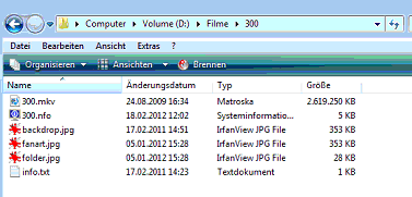

hello...
i have read this and named a .jpg to "movie.jpg".
Or does this mean, the .jpg musst be named for example "Avatar.jpg" ??
mike
a Movie folder, on my PC, looks like this:
Post Fri Feb 24, 2012 8:48 am
Re: Philips 42PFL7606K video thumbnails
{media_file_name}.jpg ==> 300.jpg for 300.mkv

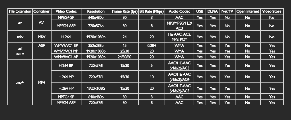

as you can see ... mkv is supported !
exctract from my manual

ok let see if the manual is correct.
remove this line from the philips profile

mike9677 wrote:as you can see ... mkv is supported !
only with 24fps ?!

you need to restart both serviio server and console ( generially its easy to just restart pc after making the change).
i didnt expect it to work, it was to show you that even though it says in the manual that they are supported that actually they are not, so theres nothing we can do, but transcode them like we had.
