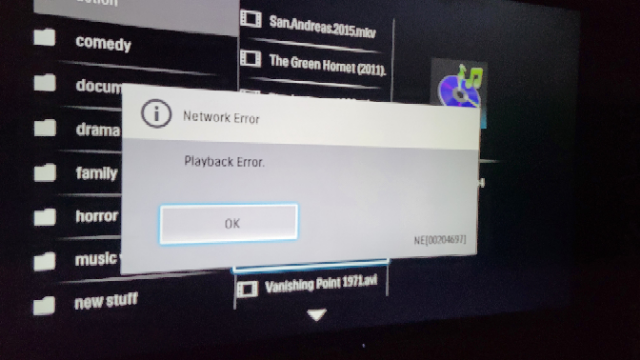

same thing, its like it doesn't even try to play the files instantly I get that network error ? on my Samsung I have had a few that it will try to play and I get not supported but that's not often . on this phillips its like it doesn't even try

so i havent had time to do the log thing but hate wifi so i ran a ethernet cable to it , didnt do anything different and really didnt expect it to. then i went to the darkside for experimental purposes only and installed plex. dont like it only use serviio but even that i get the same error. wtf. i am going to try tonight some random files on a usb drive and see if it plays from that if its even capable of that but other than that i am lost. phones, boxes and my tvs all play serviio fine. i even have a old sony box that doesnt do anything but serviio. i will try over the weekend to get a log file.
