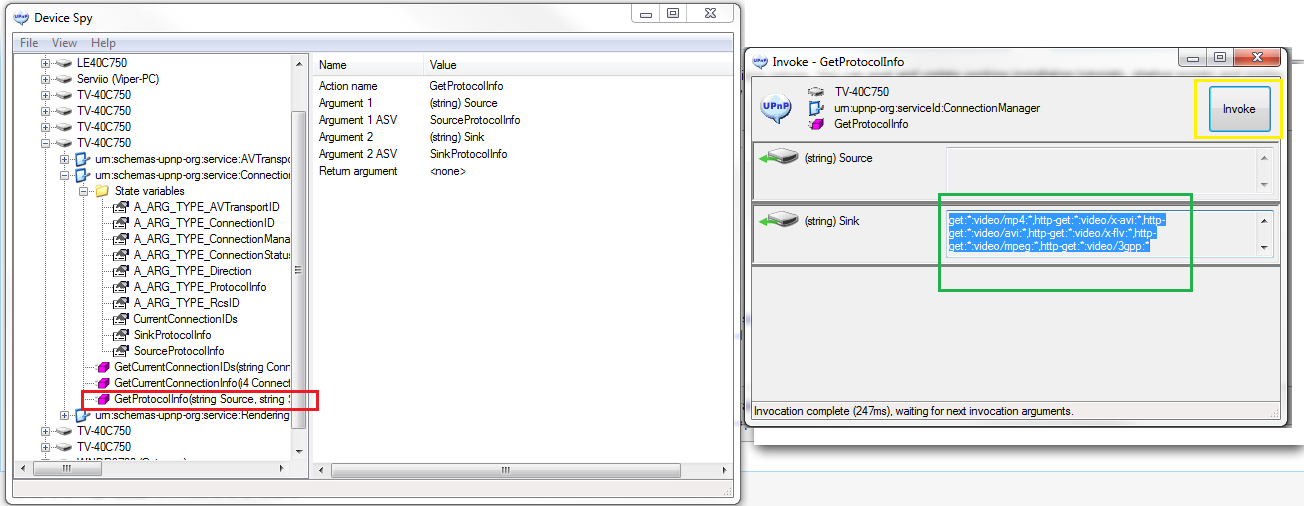

I have no idea how to do that. I read you wiki link and downloaded that soft but dont know anything else. Can you point me into right direction please.
One way is to send me the Sink protocol information of your device.
Install Intel UPnP tools <------------ did that
run Device Spy <------------where/what is that ?
It should list all your UPnP device and among them yout device (eg TV, console, etc)
Expand the device's tree and find service: urn:upnp-org:serviceId:ConnectionManager:1
Expand that and double click on GetProtocolInfo(…).
Click on Invoke and send me (or attach a file) the result in field Sink. If you feel like it you can as well add it to our database.
Alternatively, if your device doesn't appear in DeviceSpy, search for it's supported features via DLNA Product Search.
Post Sun Jan 08, 2012 3:01 am
Re: HOWTO: Serviio on DNS-320 & DNS-325
no problem i dont mind talking you through it. :)
1. Expand the device's tree and find service: urn:upnp-org:serviceId:ConnectionManager:1
2. Expand that and double click on GetProtocolInfo(…). (Red Box)
3. Click on Invoke. (Yellow Box)
4. Copy information to motepad and save as txt file. (Green Box)
5. Attach the txt file here so that it can be looked at by the mods/admin here and a profile made up.

got it but do i have to run my TOSHIBA with a movie or TV doesnt even have to be on ?
Cerberus wrote:no problem i dont mind talking you through it. :)
Post Sun Jan 08, 2012 3:28 am
tv has to be turned on and connected to network thats all.
