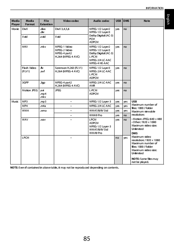

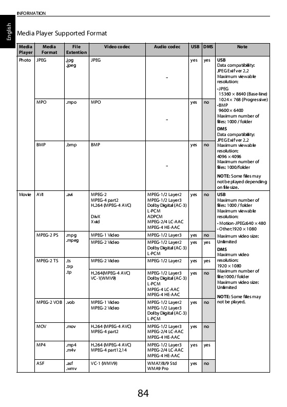

Here is my DeviceSpy sink info for Toshiba 32RL958 (I thought it was called an 32RL958B)
I have also included the 2 pages from the user manual that says what formats are supported. Note, that a lot of the formats are USB only and not available via DMS (DLNA Media Server). I don't know whether the extra USB formats are contained in the DeviceSpy sink info (or whether some of them actually work via DMS - someone said the user manual on their TV said items would not work but when he tried they did).
RL958.txt
Sink text
(2.61 KiB) Downloaded 2610 times
Supported formats from user manual - may be out of date
RL958-3240-English-Specific___Media_Player_Supported_Format page 1 of 2.jpg (111.27 KiB) Viewed 66250 times
RL958-3240-English-Specific___Media_Player_Supported_Format page 2 of 2.jpg (87.61 KiB) Viewed 66250 times
Darren .)

DarrenNewsgroup wrote:Here is my DeviceSpy sink info for Toshiba 32RL958 (I thought it was called an 32RL958B)
I have one of these too, as well as its 40-inch version. The current Toshiba profile seems to play most formats but, as mentioned elsewhere, does not allow for pausing or forwarding/rewinding. Is there any likelihood of improving the navigation or is this as good as it can get?
Post Sun May 12, 2013 7:43 pm
Re: DLNA Device Support Information.
Try the Generic profile, which doesn't transcode. It looks like the Toshiba can't seek transcoded content.
