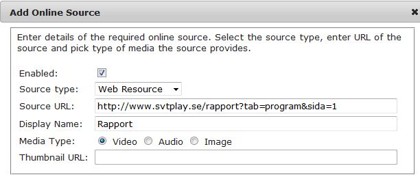

Post Fri Dec 27, 2013 4:35 pm
Re: SvtPlay
Hello...
I am abroad and have some interest to watch some Swedish news and other shows. I have installed Serviio 1.4 on my QNAP. It is working fine for most of the stuff, but have tried to add the SvtPlay web resources without luck. The 'Source URL' i have added is:
http://www.svtplay.se/rapport
And
https://www.svtplay.se/rapport
None of them seem to work. When I press save the following is shown in .../.qpkg/Serviio/log/serviio.log
2013-12-27 20:07:33,197 WARN  [ServiioStatusService] ConversionException occured. Returning error code 500 to the REST layer. Message: No enum const class org.serviio.library.metadata.MediaFileType.Video : No enum const class org.serviio.library.metadata.MediaFileType.Video
---- Debugging information ----
message             : No enum const class org.serviio.library.metadata.MediaFileType.Video
cause-exception     : java.lang.IllegalArgumentException
cause-message       : No enum const class org.serviio.library.metadata.MediaFileType.Video
class               : org.serviio.library.metadata.MediaFileType
required-type       : org.serviio.library.metadata.MediaFileType
converter-type      : com.thoughtworks.xstream.converters.enums.EnumConverter
path                : /repository/onlineRepositories/onlineRepository/fileType
class[1]            : org.serviio.ui.representation.OnlineRepository
converter-type[1]   : com.thoughtworks.xstream.converters.reflection.ReflectionConverter
class[2]            : java.util.ArrayList
converter-type[2]   : com.thoughtworks.xstream.converters.collections.CollectionConverter
class[3]            : org.serviio.ui.representation.RepositoryRepresentation
version             : null
I have read your sticky post and in that is says that SvtPlay is using HTTPS nowadays, so I have recompiled the FFMPEG with HTTPS support.
# ./ffmpeg -protocols

But doesn't matter if I add with 'http://' or 'https://' same fault. Also stated in the sticky post that SvtPlay don't restrict on location anymore. But if that is the case I will be able solve that, just want to know if it is still no restriction...
To me this looks like a bug in Serviio 1.4.
krille.com wrote:But doesn't matter if I add with 'http://' or 'https://' same fault. Also stated in the sticky post that SvtPlay don't restrict on location anymore. But if that is the case I will be able solve that, just want to know if it is still no restriction...
You should not alter the protocol used for the feed url (http). The https is for the actual stream, the URL to which the plugin delivers and which Serviio uses for playback.
If you can play the show in a browser from your current location, then Serviio should be able to play it as well.
You may try to enable debug log and see the exact url which Serviio tries to index. Then try to play that through ffmpeg and see if you get a more specific error message.
Other suggestions: did you mark the feed as a Web Resource? (NOT RSS).
Also, try altering the feed url thus:
http://www.svtplay.se/rapport?tab=program&sida=1
I don't have time to install Serviio 1.4 and troubleshoot the issue today. I might later this week.
Happy New Year!
/ O
krille.com
Joined: Wed Dec 25, 2013 3:43 pm
Post Mon Dec 30, 2013 10:37 am
Re: SvtPlay
Hello...
Thanks for your answer. I believe it must be a bug in Serviio as well. I have noticed that when I save the 'Web Resource' and then flip from
Library' tab to another tab and then back to 'Library - Online Sources' the added and saved is not there. Also when I try to choose 'edit' on the added web resource it is empty...
Thanks I will try another section in the forum, since I believe it can't be the plugin fault here... But if you will have time to install 1.4 and try, just let me know if it worked or if you have the same experience as me...
Thanks again! Happy New Year!
/k

Re: SvtPlay
Hello Otto...
There has been a new release for Serviio and this time the Online Source is saved :)
But I get a WARN in the log file when I add the Web Resource
2014-02-08 20:59:59,972 WARN  [FeedUpdaterThread] An error occured while parsing the online resource http://www.svtplay.se/rapport?tab=program&sida=1, waiting for expiry time to try again: Error during feed parsing, provided URL probably doesn't point to a valid RSS/Atom feed. Message: Invalid XML: Error on line 39: The content of elements must consist of well-formed character data or markup.
org.serviio.library.online.metadata.OnlineResourceParseException: Error during feed parsing, provided URL probably doesn't point to a valid RSS/Atom feed. Message: Invalid XML: Error on line 39: The content of elements must consist of well-formed character data or markup.
        at org.serviio.library.online.feed.FeedParser.parse(FeedParser.java:105)
        at org.serviio.library.online.OnlineLibraryManager.findResource(OnlineLibraryManager.java:179)
        at org.serviio.library.online.OnlineLibraryManager.findResourceInCacheOrParse(OnlineLibraryManager.java:198)
        at org.serviio.library.online.metadata.FeedUpdaterThread.getOnlineItems(FeedUpdaterThread.java:185)
        at org.serviio.library.online.metadata.FeedUpdaterThread.run(FeedUpdaterThread.java:108)
Caused by: com.sun.syndication.io.ParsingFeedException: Invalid XML: Error on line 39: The content of elements must consist of well-formed character data or markup.
        at com.sun.syndication.io.WireFeedInput.build(WireFeedInput.java:226)
        at com.sun.syndication.io.SyndFeedInput.build(SyndFeedInput.java:136)
        at org.serviio.library.online.feed.FeedParser.parseFeedStream(FeedParser.java:120)
        at org.serviio.library.online.feed.FeedParser.parse(FeedParser.java:88)
        ... 4 more
Caused by: org.jdom.input.JDOMParseException: Error on line 39: The content of elements must consist of well-formed character data or markup.
        at org.jdom.input.SAXBuilder.build(SAXBuilder.java:468)
        at com.sun.syndication.io.WireFeedInput.build(WireFeedInput.java:222)
        ... 7 more
Caused by: org.xml.sax.SAXParseException: The content of elements must consist of well-formed character data or markup.
        at com.sun.org.apache.xerces.internal.util.ErrorHandlerWrapper.createSAXParseException(Unknown Source)
        at com.sun.org.apache.xerces.internal.util.ErrorHandlerWrapper.fatalError(Unknown Source)
        at com.sun.org.apache.xerces.internal.impl.XMLErrorReporter.reportError(Unknown Source)
        at com.sun.org.apache.xerces.internal.impl.XMLScanner.reportFatalError(Unknown Source)
        at com.sun.org.apache.xerces.internal.impl.XMLDocumentFragmentScannerImpl$FragmentContentDriver.startOfMarkup(Unknown Source)
        at com.sun.org.apache.xerces.internal.impl.XMLDocumentFragmentScannerImpl$FragmentContentDriver.next(Unknown Source)
        at com.sun.org.apache.xerces.internal.impl.XMLDocumentScannerImpl.next(Unknown Source)
        at com.sun.org.apache.xerces.internal.impl.XMLNSDocumentScannerImpl.next(Unknown Source)
        at com.sun.org.apache.xerces.internal.impl.XMLDocumentFragmentScannerImpl.scanDocument(Unknown Source)
        at com.sun.org.apache.xerces.internal.parsers.XML11Configuration.parse(Unknown Source)
        at com.sun.org.apache.xerces.internal.parsers.XMLParser.parse(Unknown Source)
        at com.sun.org.apache.xerces.internal.parsers.AbstractSAXParser.parse(Unknown Source)
        at com.sun.org.apache.xerces.internal.jaxp.SAXParserImpl$JAXPSAXParser.parse(Unknown Source)
        at org.jdom.input.SAXBuilder.build(SAXBuilder.java:453)
        ... 8 more
I don't understand why it states RSS/ATOM feed, when I am sure adding a Web Resource?!?
krille.com
Post Sat Feb 08, 2014 5:21 pm
Re: SvtPlay
Some more bug in Serviio rev2, it changes back the type to RSS Feed all the time, even if I change it... So I will check other places...
Cheers
