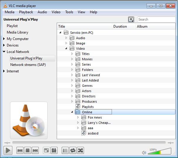

RSS Feed works from one server, but does not work from other
The feed aaa is working one, the feed 'asdasd' does appear but its empty. In real, it contains 4 videos.
we have multiple servers where users store some media files. We want them to be able to access those files through DLNA by providing RSS Feeds. The same script is generating RSS Feeds, but it works from one server and does not from other. I have tryed many things - with no results. The server where it works uses Debian and is accessed by IP address without DNS, the server where it does not work uses CPanel and is accessed by DNS representation (s1.mydomain.com).
What could be the problem ? Could i somehow enable debugging in serviio, so i see where the problem occurs ?
The non-working feed will appear in DLNA, but without any contents.

how does the feed look like? can you post the contents? Otherwise enable detailed logging to see if the feed is parsed properly.

Thank you very much, i have enabled debugging and found the problem. It was not in RSS but because files transfer got corrupted.
