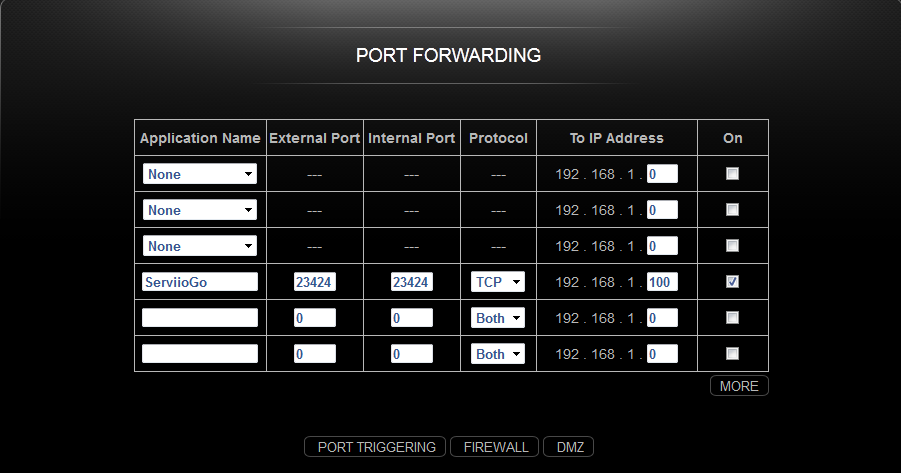

I am having a problem setting ServiiGo on my Android phone.
I opened the ports on my router to 23424, and went to dnsdynamic.org to set up a dynamic DNS for my IP, ie: xxxxxxxxx.dnsdynamic.com. I entered this information into ServiiGo on my phone, along with my password and clicked Log In. It just keeps trying to log in with the spinning wheel and never connects. I have no problem connecting locally, it's just setting up the "on the go" that I'm having a problem with. What am I doing wrong?
Thanks for any help.

can you connect to MediaBrowser?
http://xxxxx.dnsdynamic.com:23424/mediabrowser
If not the port forwarding is not working yet. Did you setup port forwarding on your router? (to pass the traffic from your public IP to the PC running Serviio)

JohninLA wrote:I am having a problem setting ServiiGo on my Android phone.
As zip said, it sounds like port forwarding isn't setup properly. If you can visit http://xxxxx.dnsdynamic.com:23424/mediabrowser from your phone in your webbrowser then it is setup, otherwise it isn't.

zip wrote:can you connect to MediaBrowser?
OK, it looks like this is the problem then as I cannot connect to the mediabrowser. I forwarded the ports as shown on the attachment. I then restarted my router. What else do I need to do to get it to work?
Thanks zip and will .

JohninLA wrote:OK, it looks like this is the problem then as I cannot connect to the mediabrowser. I forwarded the ports as shown on the attachment. I then restarted my router. What else do I need to do to get it to work?
Go to http://www.yougetsignal.com/tools/open-ports/ and enter 23424 into the port box. If it says it is open, then the router is setup, the the dynamic dns is not. In which case login to the dynamic dns account and make sure the ip address it has is the same as what the port fordward test site says.

is 192.168.0.100 the IP of the Serviio server PC? if yes, you can try http://www.whatismyip.com/ and try opening mediabrowser using that IP address

Post Fri Jul 27, 2012 6:15 pm
Open port checker tool is showing that port 23424 is closed on my firewall. I am not sure what to do with it as I opened in my router, restarted the router, restarted my pc.
192.168.1.100 is the server address for my pc where Serviio is installed.

JohninLA wrote:Open port checker tool is showing that port 23424 is closed on my firewall. I am not sure what to do with it as I opened in my router, restarted the router, restarted my pc.
Try (temporarily) disabling the windows firewall on the pc where Serviio is installed.
Also, I opened both 23423 and 23424 - on my router and my windows firewall - because I read both used in directions, one may have been a typo but I wasn't sure.
