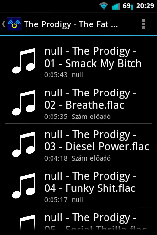

* In some cases there are "null" strings before the name of audio songs:
Maybe it's because ID3 tags...
* Audio playback is not working at all - it just displays the item name.

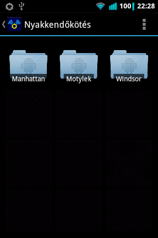

* Adjustable listing of media: Just thumbnails, Thumbnails with filename, Thumbnails with all details, Details only etc.
In the images browsing it's not easy to read folder names on the icons when there are a lot of folders.
It would be nice to have a displaying style like in audio or video: one folder / line, displaying how many items are in the folder.

mavika wrote:* In some cases there are "null" strings before the name of audio songs:
Yes I noticed that on one of my files, i'll fix that.
Good idea,for this i'll need to grid views for everything (but with only 1 column for most views), however, there are a few gotchas though which i'm still working out. Any suggestions for making the image folder names easier to read? I need to replace the folder icon, but anything else that would help?
Do you mean for images?
* ServiiDroid like login page. More servers, search for servers, etc.
This is something i've debated, I think the default will be just one server, and give an option to have a list of servers.
Search for servers only works via Wifi when on your homenetwork, this app is more designed for working outside of your network as well.

will wrote:... Any suggestions for making the image folder names easier to read? I need to replace the folder icon, but anything else that would help?
... Do you mean for images? ...
The folder icon looks good, and the folder names are easy to read - if there are not too many folders, and the folder names are not too long.

@will:
I have no better idea for the image folders browsing layout. I think in this form it's very usable and looks good.
Just one remark / question:
During the video browsing - are those folders hidden which doesn't contains video media?
It depends on Serviio Server or can you filter it in ServiiGo?
If that can be made on images (and maybe on audio too) that would solve my previous problem.
For example: I have a folder shared in Serviio that contains a lot of subfolders with all 3 kind of media (audio-video-images).
Then during browsing the images folder in ServiiGo, I have to scroll through all other empty subfolders, that contains video-audio.
If those empty folders could be hidden - then it would be easier to browse.
I don't know if it's a DLNA thing or it is possible to handle.

mavika wrote:During the video browsing - are those folders hidden which doesn't contains video media?
Are you talking about the folders view? At the moment I don't do any filtering so if Serviio sends me an empty folder I will display it, but I can certainly add an option in the settings to hide empty folders.

will wrote:Are you talking about the folders view? At the moment I don't do any filtering so if Serviio sends me an empty folder I will display it, but I can certainly add an option in the settings to hide empty folders.
Yes, that's what I'm talking about. :)
That option to hide empty folders - sounds great.
Post Sun May 27, 2012 4:24 pm
Re: ServiiGo - Android 3G/Wifi Playback App - Beta
mavika wrote:Yes, that's what I'm talking about. :)
Ok that will be in the next beta then along with the other layout suggestions and audio playback.
