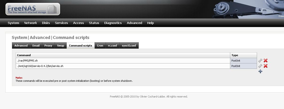

Mrks: I have serviio server running in background but that is thanks to freenas user-friendliness, not because of my bsd knowledge:) see picture attached
Ursus: you ll find my serviio.sh below.
One comment though: I could not connect to the bsd server (192.168.1.5) from the xp client, although I also modified the client side to refer to the ip 192.168.1.205.
I am happy to have someone to correct my config if needed.
Fafa

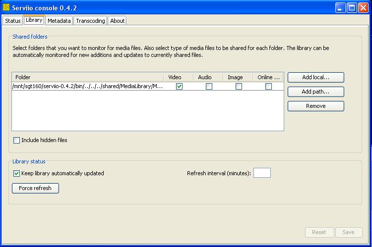

Oops. Rewind everything, I need some sleep:
- I could not run serviio server in background, even using the nice ui of freenas
- I can run serviio server from a putty windows and then connect from windows ui to the shell-launched serviio.sh
The windows client works properly * except * that I have to play with the path of the media: whatever the path I enter (/mnt/data/somefolderswithmedia) the gui always get troubled with the windows and unix syntax (which is fine I guess) but also more strangely with the root of the media directory: it always adds up the unix path of the serviio.sh:
[LibraryUpdatesCheckerThread] Looking for removed/updated files in repository: /mnt/sgt160/serviio-0.4.2/bin/\\192.168.1.205\shared\MediaLibrary\Music
the workaround consists in playing manually with the media path, see picture.
So 2 questions:
- why does the background mode resist/what are we missing?
- a potential minor bug to be explored on the gui side?
thx!

Re: Running server side on FreeBSD
you should just be able to add a path using the "Add path.." button and entering a path local on the server side, e.g. /home/user/videos. Not sure how are paths resolved on the NAS though.
ursus
Joined: Thu Sep 30, 2010 10:36 am
Post Sat Oct 02, 2010 7:22 am
Thanks a lot! It's now running...

ursus
Post Sat Oct 02, 2010 12:27 pm
thanks ! It now works! Thank you very much for your help..
btw: I got it to autostart in freenas.. I've added a command in System|Advanced|Command scripts .
type postinit
cd /mnt/SystemData/serviio/serviio-0.4.2/bin && ./serviio.sh
fafa
Posts: 30
Joined: Mon Sep 27, 2010 8:03 pm
Post Sat Oct 02, 2010 7:43 pm
yep, i got that working too
btw what is the difference with ./mnt/SystemData/serviio/serviio-0.4.2/bin/serviio.sh ?
can you play movies/transcode ?
only pictures and audio work for me so far

Post Sat Oct 02, 2010 8:13 pm
fafa wrote:a. you are right, adding the resource through the 'add path' works ok, this is the 'add local' that mixes up nt and bsd syntax. I ll stick to the first one I guess!
Add local is meant to add files 'local' to the console. For remote console there is the Add path option.
c. I wonder how serviio handles two media with the same name, located in different folders. typical example is img1.jpg in folder 20100101 and img1.jpg in folder 20090101
It's no problem, they'll both be added.
