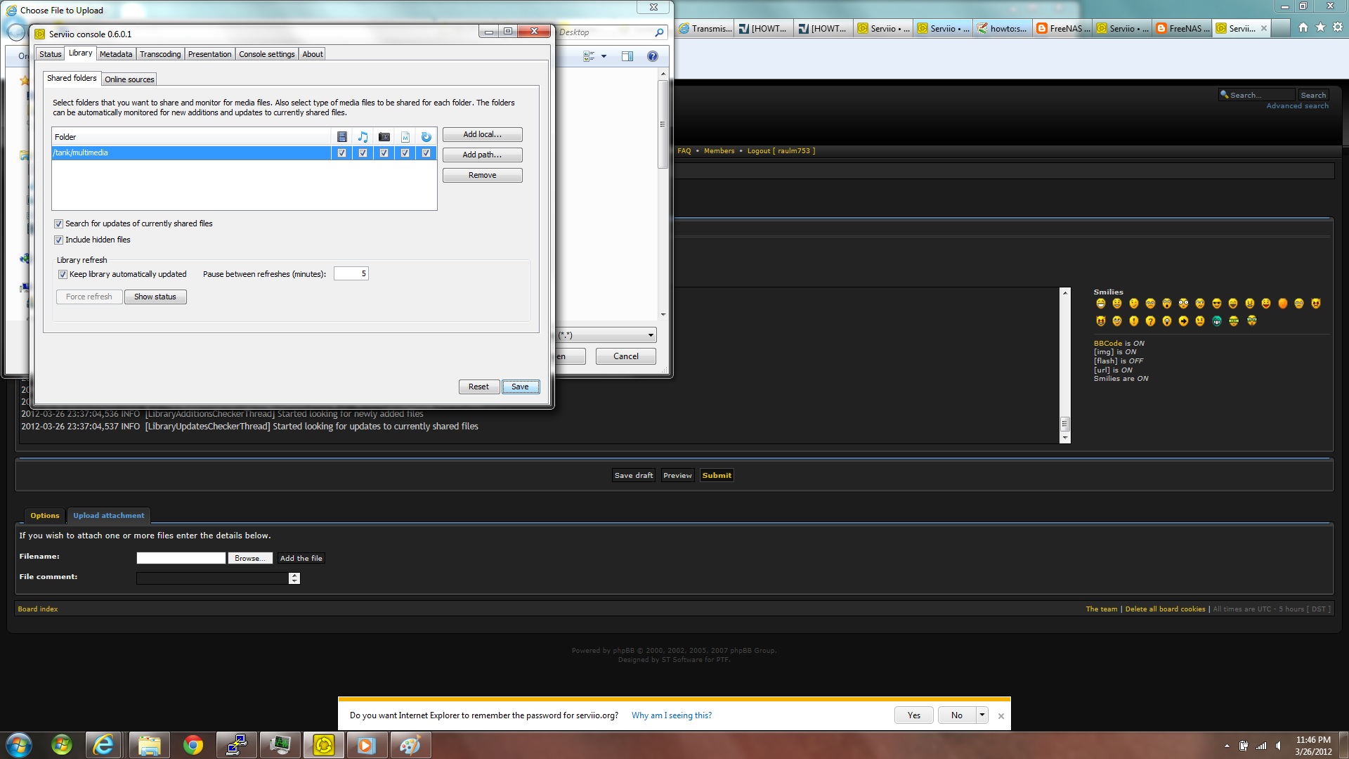

Hi after much work and frustration i manage to install serviio on freebsd 9.0. Then I was able to connect to the server through the windows serviio-console. I set my shared folder to /tank/multimedia and nothing happens :(. I can see the server through windows media player but no video shows up. here is my log file

Does the serviio user have access to the folder? Is the folder on the computer serviio is running on?. I would check permissions.
raulm753
Joined: Tue Mar 27, 2012 3:41 am
Post Tue Mar 27, 2012 12:29 pm
Re: Serviio Not updating libraray
moltra wrote:Does the serviio user have access to the folder? Is the folder on the computer serviio is running on?. I would check permissions.
Im a noob when it comes to freebsd. I figure out how to change the user, still same behavior. The folder share that im trying to share has the permissions 777 and owned by nfs:nfs.
I also running transmission and samba and they can see the folder. I installed minidlna and it can see the folder and share them. So I dont know what wrong with serviio.
yes serviio has access to the folder
yes the folder is on the computer that serviio is running on.
