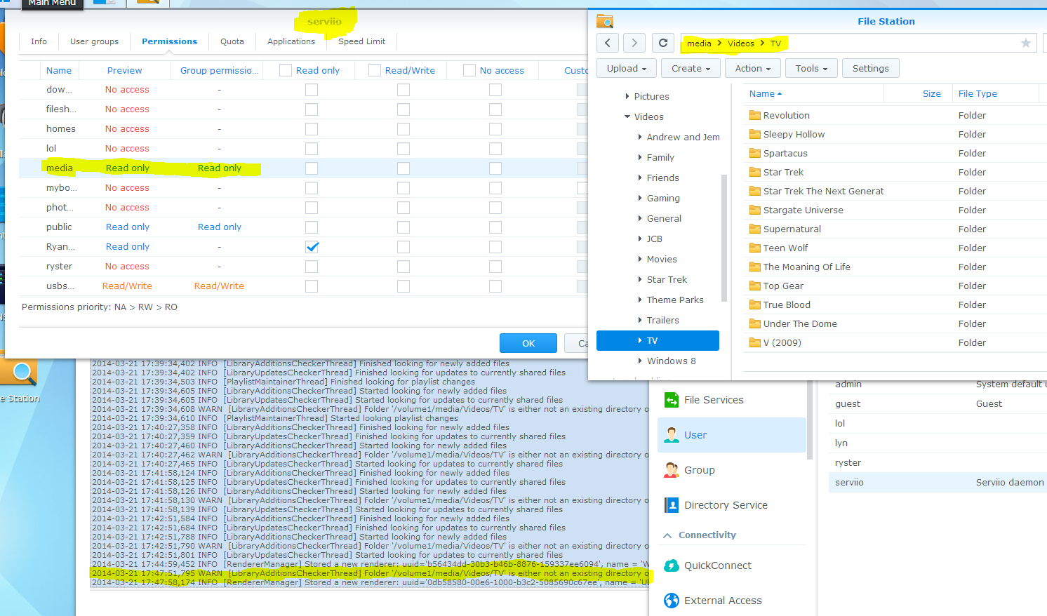

Something's gone wrong on my Synology DS213+ box recently, and now Serviio can't see the "media" share on my box.
The error from the log is:
2014-03-21 17:47:51,795 WARN [LibraryAdditionsCheckerThread] Folder '/volume1/media/Videos/TV' is either not an existing directory or cannot be read due to access rights

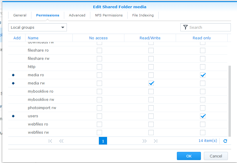

However I can confirm that the serviio user has been granted RO rights to this share, and the capitalisation of folder names matches. I'm at a loss. I've re-installed both Java and Serviio a few time snow to try and fix this, without success. I've also tried changing permissions so that the users group, of which the serviio account is a member, also has read access to the media share, again without success.
Any ideas what I'm doing wrong? This used to work fine. Is this a DSM 5 issue?

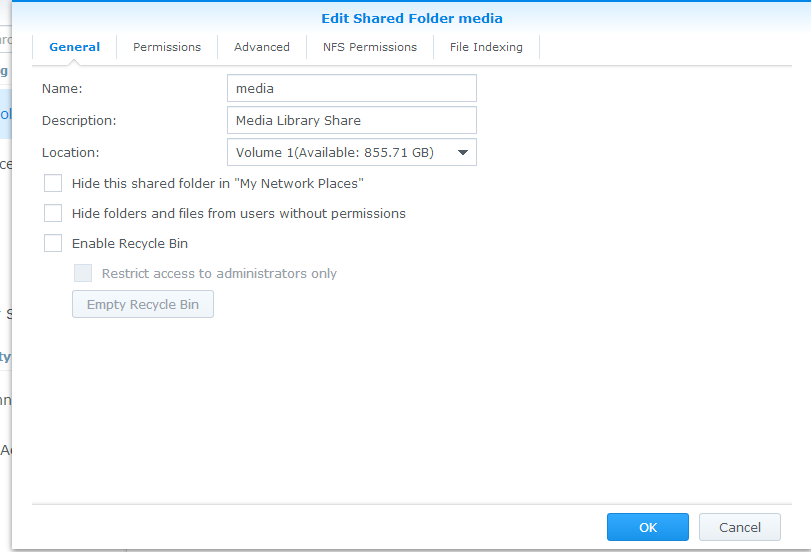

Edit: Here are some screenshots... hoping you'll see something obvious that I have missed....
Settings 1
Settings 2
Settings 3
Update: Just tried creating a new share called media 2, and moving all the video content from media into media2. This wouldn't add either.

Argh... an infuriating hour of trial and error has led me to the solution.
It seems that group memberships aren't working for some reason. If I explicitly give the serviio user read access to the share, rather than just giving it to the group that the serviio user belongs to, then serviio can read the data.
