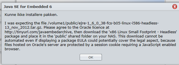

I am trying to install Serviio on my Synology nas, but I have problems installing Java.
When the installation start I received following message in attached file.

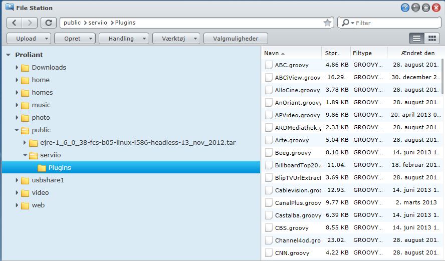

I have also attached picture of my file location in my server.

You have uncompressed the Java archive. Don't do that. Leave it as a .tar.gz file.
