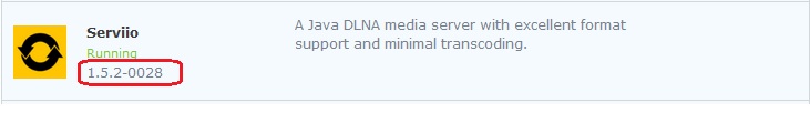

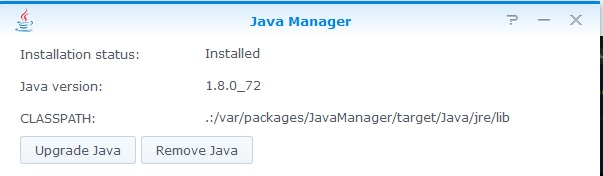

kretzu77
Joined: Sun Feb 07, 2016 9:11 am
Post Sun Feb 07, 2016 9:21 am
Re: PACKAGE: Serviio 1.6 - Synology NAS, with HW transcoding
Hi there,
I tried everything and I still have port 23423 issue
My current version is 1.5.2-0028
but still I can't update Serviio
My java is 1.8.0_72
Can you help me somehow please?
TY
patters
Posts: 1282
Post Sun Feb 07, 2016 10:56 am
Seems to be an issue I didn't get during testing. Have a look here for the solution:
viewtopic.php?f=14&t=3311&start=220#p106588

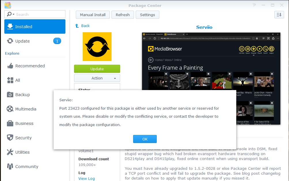

frankwbb
Joined: Sat May 21, 2016 1:21 pm
Post Sat May 21, 2016 1:27 pm
Re: PACKAGE: Serviio 1.6.1 - Synology NAS, with HW transcodi
I updated it from version 1.6 to 1.6.1. After the download I get the following message (see attachment).
I take this from this threat but it don't solve the problem:
viewtopic.php?f=14&t=3311&start=220#p106595
Best regards

Joined: Fri Jan 30, 2015 4:46 pm
Post Sun May 22, 2016 8:32 am
Hello, there is a problem with 1.6.1?
I updated (at least i wanted) from 1.6 to 1.6.1. First i get some java related error, but after i resolved that i cant install serviio anymore. I get the port error:
I tried to clean all Serviio Related things from my NAS, several restarts, also i verified if the port 23423 is used by another process, but it doesent.
Can you check it? Or can you recommend me what anything else i should try?
patters
Posts: 1282
Post Sun May 22, 2016 1:11 pm
This does not happen on my system. Did you do something non-standard when 1.6 first came out, and there were issues upgrading from 1.5.2? I remember someone on here published some instructions to edit the firewall definitions registration inside the package and I urged people not to do this as they would end up with an orphaned firewall definition.
Try restarting the NAS, sometimes that can glitchy fix port conflict messages.
