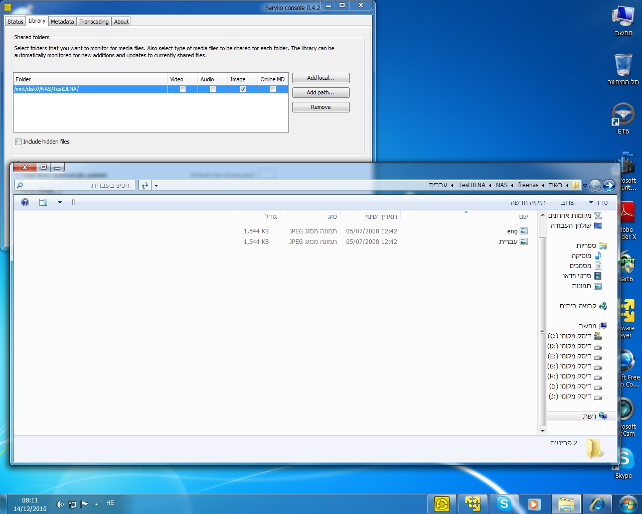

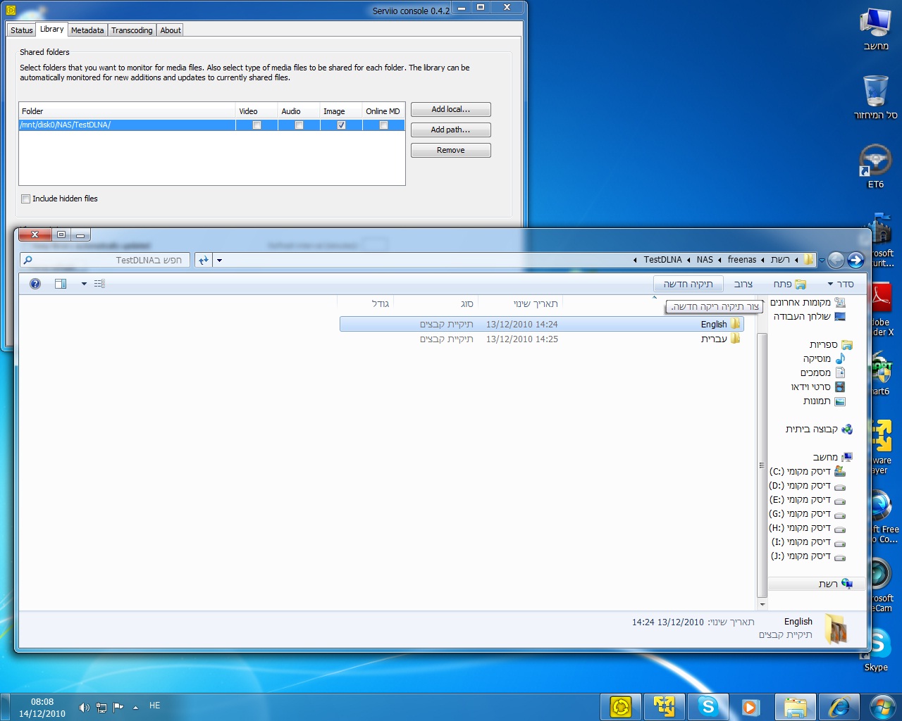

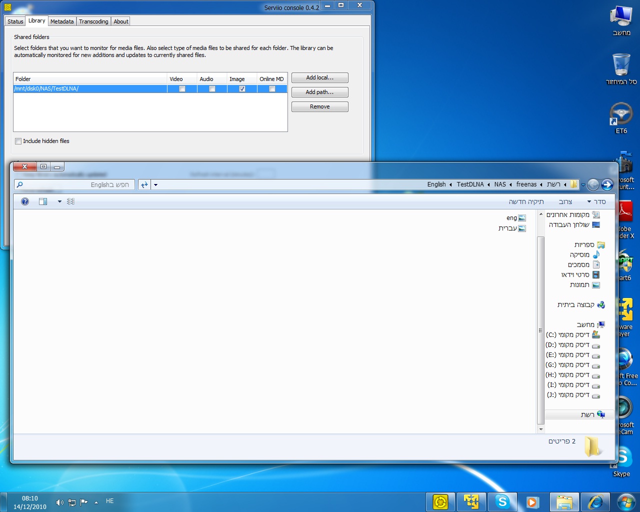

pictures of the SMB view in wodws of the main folder the english named folder and the hebrew named folder.
