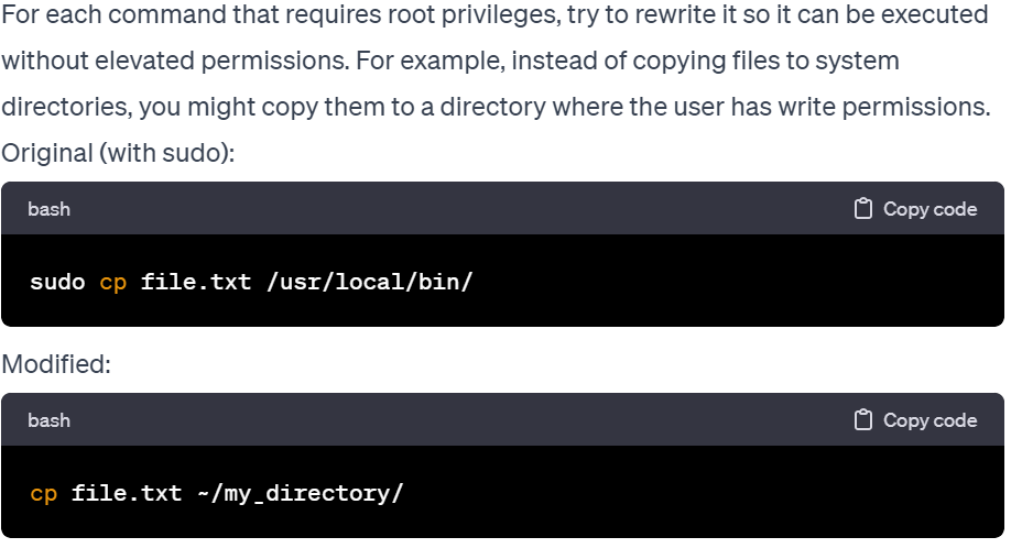

I used for funn ChatGPT to see what he will say about it.
Review the Script:
Start by looking through the installation script. Identify the parts where it requires root privileges (usually commands with sudo or directly manipulating system files). Note down these sections.
User Permissions:
Ensure that the user you intend to use for the installation has sufficient permissions. If the script requires specific permissions, grant them to the user.
Modify Script Commands:
For each command that requires root privileges, try to rewrite it so it can be executed without elevated permissions. For example, instead of copying files to system directories, you might copy them to a directory where the user has write permissions.
Original (with sudo):
bash
Copy code
sudo cp file.txt /usr/local/bin/
Modified:
bash
Copy code
cp file.txt ~/my_directory/
Install in User Directory:
If possible, modify the script to install the software in a directory owned by the user rather than a system directory. This is a common practice for software that doesn't require system-wide installation.
Dependencies:
Make sure all dependencies required by the script are installed and accessible by the user.
Testing:
Test your modified script thoroughly. Ensure that the software is functioning correctly and that no unexpected issues arise.
Documentation:
Update any relevant documentation or comments in the script to reflect the changes you made and any specific requirements for users running the script.
Ask for Help:
If you encounter specific issues or error messages during the modification process, feel free to seek help from online forums or communities. Others may have faced similar challenges and can provide guidance.
Remember to create backups before making changes, especially if the script interacts with critical system files. Additionally, note that some software may have legitimate reasons for requiring root privileges, and modifying the script might not be feasible without compromising functionality or security. Always exercise caution and adhere to security best practices.
missing picture of commands as text in post

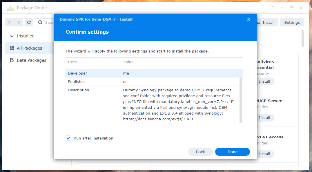

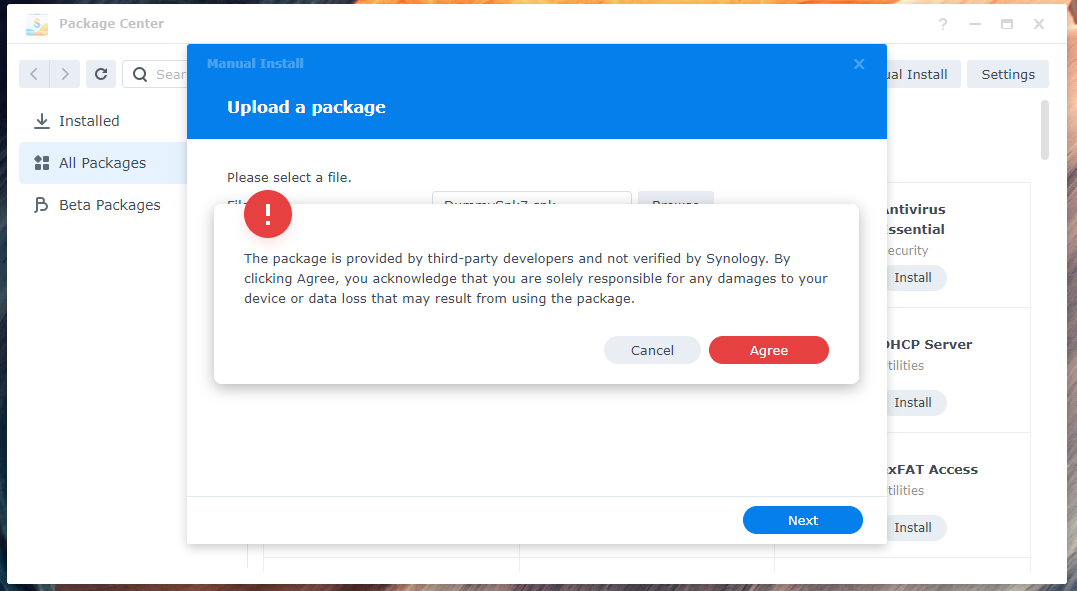

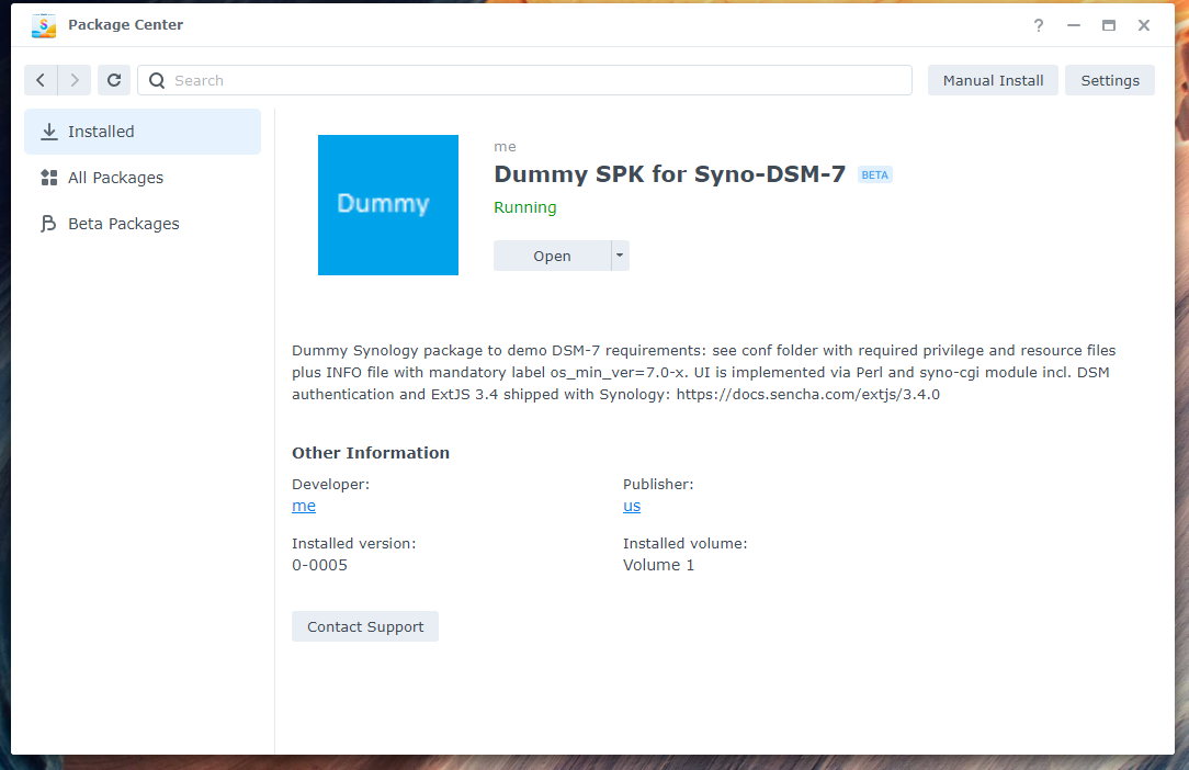

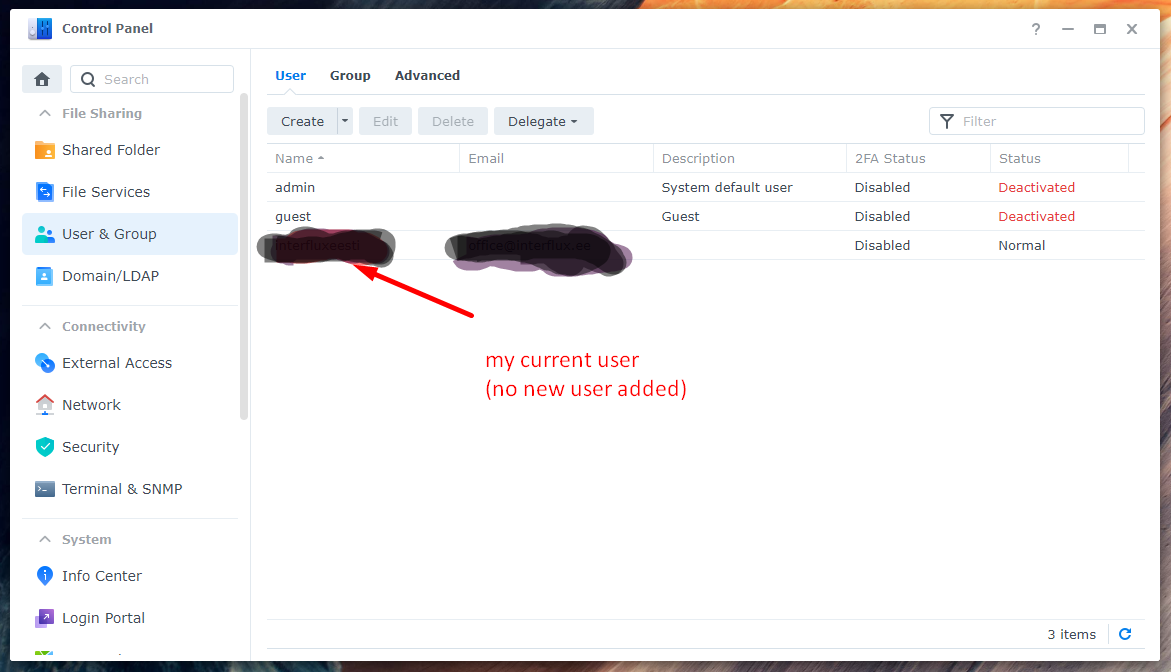

Added new file, it "should" create a new "user" called "Serviio" and it "should" be set up as an Admin.
Please verify this does.
The program does NOT install Serviio, it WILL install something call "dummy" .. I tested it on Synology's live demo site, so I know it installs, but the user account doesn't show up... so not sure if its them or a programming issue.
LMK.

Hi kittmaseter, i am located in EU. Time zone is +2. So, it is a bit different from your one ;)
I did a installation try. see attached pictures...
3
(3)result after install.png (124.86 KiB) Viewed 38969 times
2
(2)second info.png (109.66 KiB) Viewed 38969 times
1
(1)first warning.png (101.06 KiB) Viewed 38969 times

The last result added here... (3 pictures was max in post)
4
(4)new user.png (131.43 KiB) Viewed 38968 times

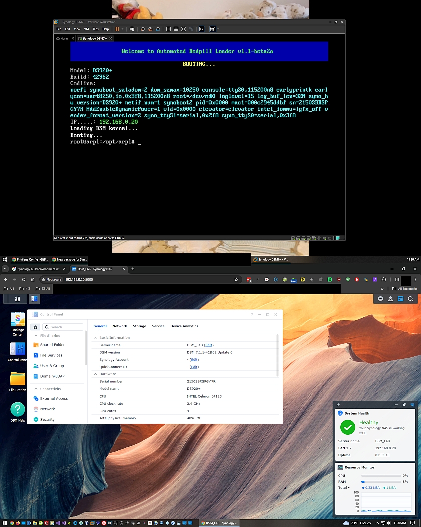

I took this the step further. This is way more complicated that I expected so I had to figure out how to test locally without screwing up my system. I found a way to install DSM7 on a Windows VMware machine. Got it up and running and it appears to be just the ticket to carry on.
The dev is going to be long and slow, I have to do this in baby steps to figure out what my next moves are. I am hoping to update progress as I go, but don't expect another .spk until I can get further in.
So the good news is, here is a screenshot if it on the VM fully operational and I've already installed packages on it both dummy and real and it works exactly the Synology hardware would. So now I have real test bed to make sure it really works and it won't screw up anyone's machine trying stuff out.
The nice thing about VMs is you can revert them via snapshots meaning, I took a snapshot of the operating system as soon as it was fully up and running with no added packages or any type of modifications as if I just took the hardware out of the box. So if something corrupts, I just restore back to the snapshot and start over. So there's that.
DSM7 in a VM
Screenshot 2024-01-18 113035-edit.jpg (461.18 KiB) Viewed 38913 times
