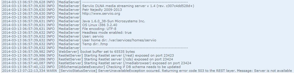

Same for me after DSM 5.0-4458 on DS412+, error code 503, Server not avaiable.
Please help...

Post Thu Mar 13, 2014 6:24 am
Re: Serviio server stops automatically on Synology DS214play
Here my log.
log

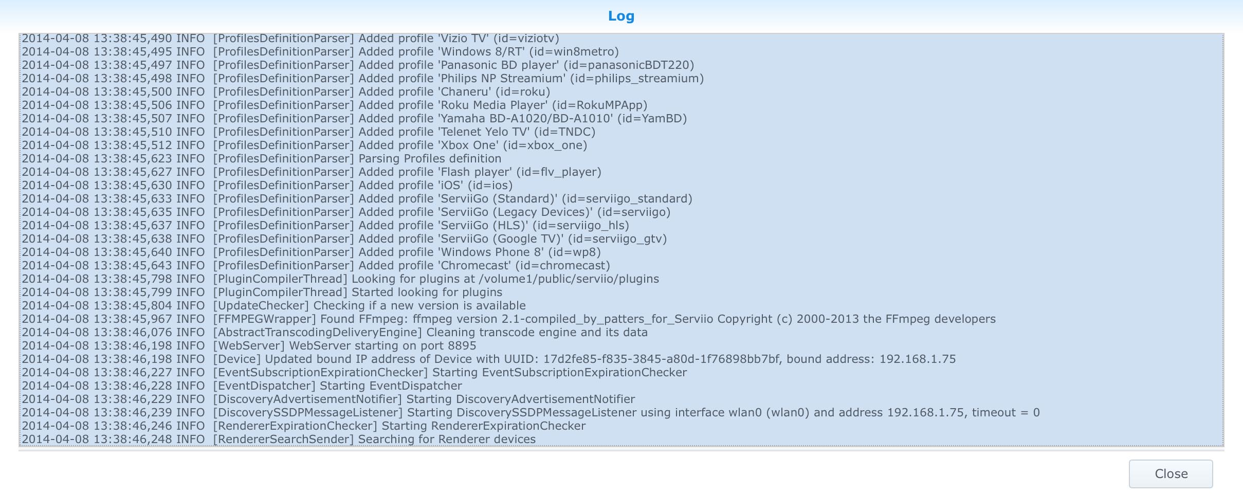

Post Tue Apr 08, 2014 11:43 am
I also made a screenshot of the log file when I start the program again. Please see attached.
Cheers,
Chris

Post Sun Apr 13, 2014 11:51 am
Im not sure - you probably need someone with the DS214play to help you.
In the log above it was finding an address 192.168.1.75. That has changed now?
Try binding the server to this adress (either using console, on the status tab, or by using the system property serviio.boundAddr, see http://www.serviio.org/component/conten ... properties for details).
