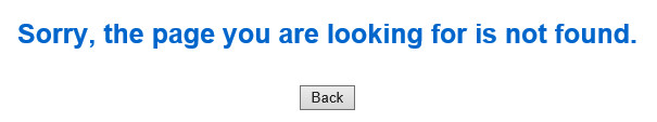

I wonder if someone could post a dummy's guide on how I could go about trying to fix my serviio console issue above.
It did work before I upgraded the Synology OS, I am on version DSM 5.0-4482
I have uninstalled the package and re-installed, but I am still getting the below when I browse to the console.
Any help to point this Synology noob in the right direction would be greatly appreciated.
Post Edit:
Reading floppyn & Herman posts sorted out my issue.
Thanks very much indeed :D

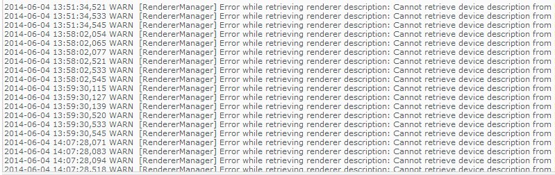

The latest DSM update seems to have broken Serviio. Any suggestions?
ianfretwell
Posts: 25
Joined: Sat Dec 14, 2013 12:59 pm
Post Thu Jun 05, 2014 12:43 pm
Re: PACKAGE: Serviio 1.4.1.2 - Synology NAS (ARMv5&v7 PPC In
Uninstall and reinstall Java on the Synology device.
Then start the Serviio application from the 'Packages' area of the Synology interface (I'm pretty sure you'll find it's no longer running after the DSM upgrade).
Morbeas
Posts: 28
Joined: Wed Jan 16, 2013 7:44 pm
Post Thu Jun 05, 2014 12:49 pm
Woohoo, that worked! Thank you. :)
