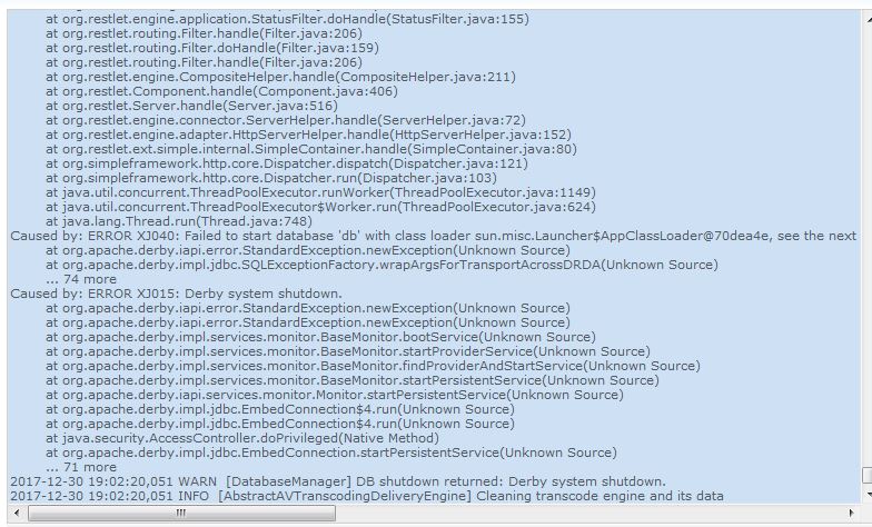

I have the same problem
LOG
Post Fri Dec 29, 2017 10:30 pm
Re: Service always stopp on synology DS18play (armv8?)
Neo, that is a rather small portion of the log, but my guess is that it can't find Java on your NAS. I can't help with installing Java, but that looks like the issue.

Similar Problem on DS916+

looks like it'S the same problem on the DS418j
as i described http://forum.serviio.org/viewtopic.php?f=14&t=24238 here

Java and Serviio packages updated with proper 64bit ARM support now. Please test.
This should fix OP's issue. The other poster with the DS418j has another separate issue in which the Java runtime seems fundamentally flawed on those Armada SoC systems. It appears to run fine for a few minutes then will just throw an exception almost at random. I have no cure for that unfortunately, and spent a while testing stuff on one of those units with zero success.
