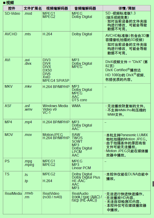

The built-in profiles for Viera do not work well for me. But I don't know how to modify the profile.
So I upload the sink protocol information and the supported formats from the manual (in Chinese, but it's easy to guess the meaning in the table).
And the last attachment is the profile in PS3 Media Server which work well for all of my videos.

Supported formats from the manual
