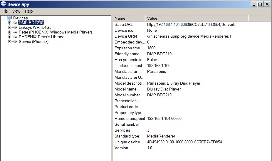

DMP-BDT210:
2012-02-06 15:52:31,442 DEBUG [RendererManager] Looking for a renderer profile for: friendly name = 'DMP-BDT210', model name= 'Blu-ray Disc Player', model number = 'DMP-BDT210', manufacturer = 'Panasonic', product code = 'null', server name = 'Linux/4.0 UPnP/1.0 Panasonic-UPnP-MW/1.0'
TC-L32E3:
2012-02-06 15:52:31,567 DEBUG [RendererManager] Looking for a renderer profile for Http headers: [User-Agent: Panasonic MIL DLNA CP UPnP/1.0 DLNADOC/1.50,Host: 192.168.1.100:8895,X-PANASONIC-DMP-Profile: ""]
Peter
Panasonic Viera TC-L32E3 LCD | Panasonic DMP-BDT210 | Windows 7 |

thanks PMI can you also do me a screen shot of the device spy window when u just select the devices please so i can try and find a way to detect the defferent models. :)
