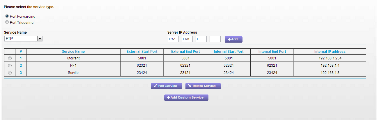

I installed Serviio yesterday and while it initially could connect between my laptop and my television, it hasn't been able to connect since. I believe I've forwarded the port correctly, and I've attached a screen shot of that page from my Netgear R6300 router. I've also attached the Serviio log.
I don't have this issue with other services i.e. PS3 Media Server or XBMC. It's just that I happen to like Serviio better, from what I've been able to see.

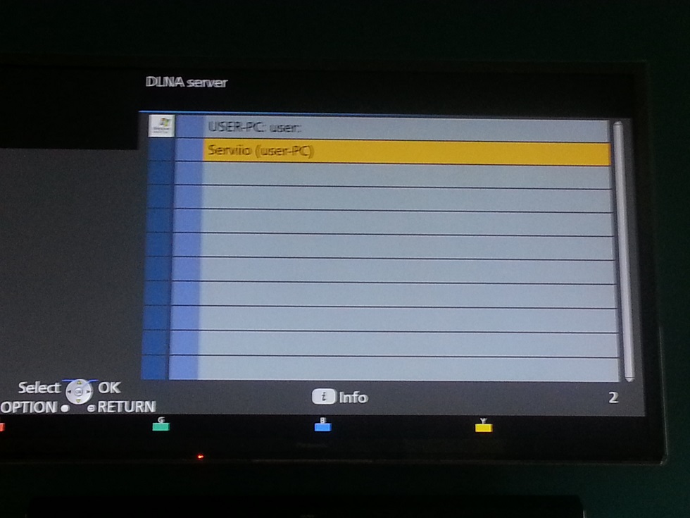

So now randomly (as happens), I can view video on my television, even though the Connectivity Status in the console displays a red x beside it when I test. Not sure how to achieve a reliable connection...

The Connectivity status button shows whether your PC is reachable for external access by MediaBrowser. While it should still show a green tick, it is not necessarily related to your TV not connecting via your internal network.
For MediaBrowser connectivity from external locations, try removing the manual port forward and ensuring UPnP is enabled in your router. Tick the "Automatically configure your router" option. This is generally all you need.

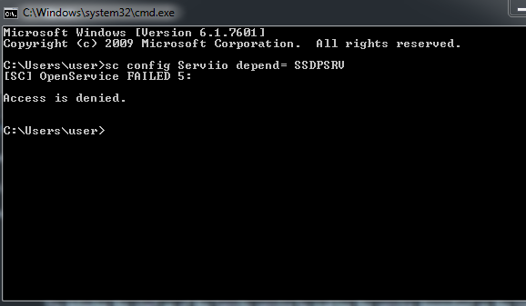

Try delaying the start up of the Serviio service by making the service dependant on the SSDP service. To do this, from an elevated command prompt type: sc config Serviio depend= SSDPSRV
I get an access denied message. See attached please. I've also attached a photo of my television screen, which has no icon beside Serviio. When Serviio isn't running, it says there are no DLNA connections on my tv, but when it is running and not connecting properly, this is how it looks.

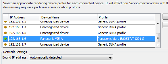

There appears to be a list of IP addresses, with 192.168.1.6 being the correct one. More often than not, it has a green dot, but sometimes it goes red... Please see attached. And although I saved the Bound IP Address as Automatic, it reverts back to 192.168.1.101. Not sure if this is what you're talking about? Thanks.

Sorry, just getting back to this. The error you get when trying sc config Serviio depend= SSDPSRV suggests you didn't run it as an elevated command prompt. You need to type cmd in the start menu and then right click on the cmd.exe that appears. Select Run as Administrator. You should be fine then to run the command.

And my apologies for taking a week to respond, but my laptop was being repaired. Tried that command as Administrator and it was successful. Having said that, Serviio is back up and running smoothly right now... Thanks very much for all your help. I'll check back in if it stops. Regards.

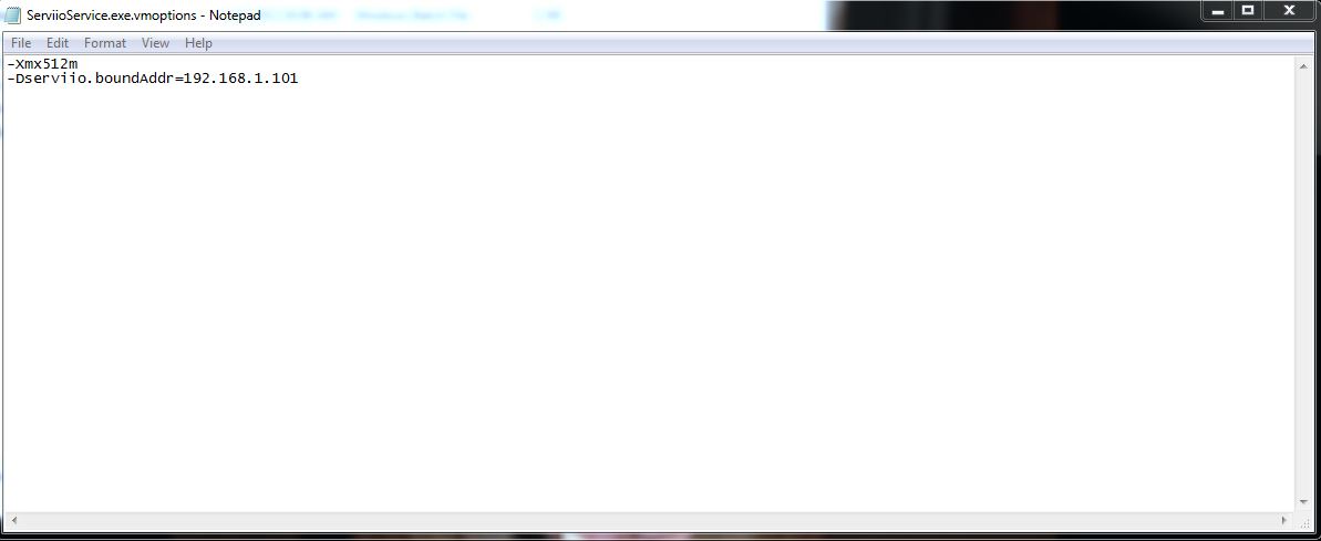

So, I can see what the problem is (if not the why). Serviio is binding to the loopback address 127.0.0.1, rather than the IP address of your server.
Can you try forcing Serviio to bind to your IP address by:
  • In Serviio console, setting the Bound IP address to your servers IP (192.168.1.101 ?). Remember to press save.
  • If this doesn't work, try adding the following to the ServiioService.exe.vmoptions file (located in the serviio\bin folder. Edit with any text editor)
      -Dserviio.boundAddr=192.168.1.101
    Restart your PC (or the Serviio service using services.msc if you know how to do that) after making the changes.
I don't seem to be able to do this. Under Bound IP Address, I have a dropdown with two options - Automatically detected and 192.168.1.6. Is there another area besides the bottom of the Status Tab where I can alter this setting?
I tried this (see attached) and restarted my computer, but no connection on the tv.
Weird - this suggests Serviio detects a WIC card with an assigned IP address of 192.168.1.6. Do you have more than one adaptor? Any idea why it would think you are on 192.168.1.6 (does this addess mean anything to you?).
Can you, from a cmd prompt, run IPCONFIG /ALL. This will list all adaptors on your PC and what IP address has been assigned.
Also, how are you assigning your PC's IP address - via a reservation list on your router or via a static address on the interface cards (ie. via Windows). You haven't got a conflict there (ie. in one you have 1.6 and the other 1.101? Shouldn't work but...).

From the earlier screenshot it appear that your Panasonic TV is using the 192.168.1.6 IP address. And in the later post your Serviio computer is using the same IP address (which you get in the bound to adapter drop down list).
I suggest you turn off both devices first, start one first, wait five minutes and then start the other one. If you are not using static IP on both the TV and the computer then you will get no conflicts.
