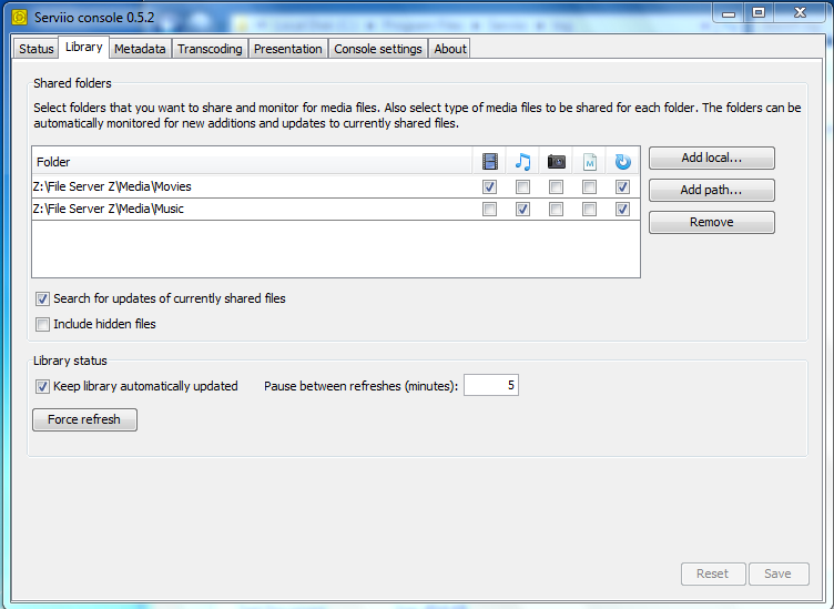

zip wrote:Check the Presentation tab to see if you have not disabled Image/Video categories.
Every single item in the list says "Display category".
mina
Posts: 14
Joined: Mon May 30, 2011 12:52 am
Post Tue May 31, 2011 12:01 am
Re: LG 47LW6500
Illico wrote:According to your Library tab settings, you only add a folder path for "images" parsing.
So no audio, no video under the serviio library, only images.
With your TV, when you'll browse audio folders or video folders, you will have empty folders.
But if you select the images category under your TV menu, read the usermanual:
Home --> Smart Share --> Select Device (Serviio) --> Photo List --> Forder
You may have all "images" of the serviio library.

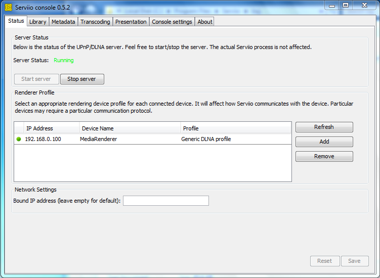

As I said before, there is no Image folder for me to browse to. If I go Home --> Smart Share --> Select Device (Serviio) it brings me to this screen:
I also get to that same screen if I choose Input --> DLNA Network.
Logically, I should at least see a folder for Images because I'm sharing a folder with three jpg files. I can understand why Audio is empty, but I cannot understand why there is no Video folder for me to browse to. Theoretically, there should also be a Video folder that is also empty, right? So confusing! :)

I have the same exact problem with my new 47lw5700 which I have an open thread as well.
If I install the included Nero media home software all my folders show and work, but with serviio all I get is a audio folder with my music. I would really prefer tobget serviio working due to its options and fkexibility...
Anyone have any ideas, can this be due to an improper dlna profile ?
