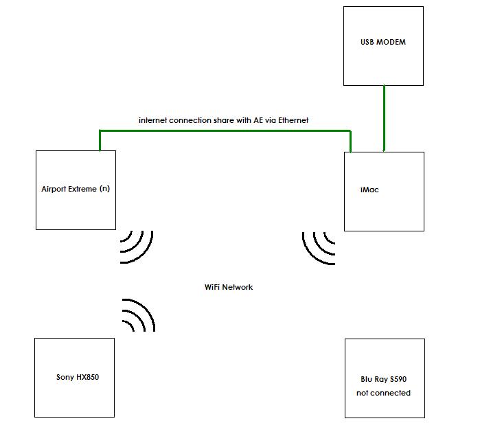

This is visual of home network setup - thought it may help with assisting me
Home Network.JPG (22.86 KiB) Viewed 8410 times
****UPDATE****
Ok without really knowing what i was doing i manually entered some IP addresses and it started working again - then computer went to sleep and know its NOT working again.
So based on this I think the issue is with my network and with how i am sharing my internet connection, so based on this assumption can some please help with the following:
If i manually set IP addresses on the following devices what whats should it look like?
just to restate i us a usb modem and share the internet via ethernet to the airport extreme. My iMac and TV then connect to the AE via wifi
In my network options I can manually set TCP/IP along with DNS for both the ethernet and the wifi,
Then based of this what should i manually set the tv IP and DNS to?
Andy
Post Tue Jan 22, 2013 8:22 am
Re: Help needed with Serviio Setup...was working now isn't
On sony network menu, could you clear all media server list and refresh a new network diagnostic?

Thank you for responding.
I have already deleted previous server that was displayed, and refreshing returned "cannot connect to server...etc.etc" message.
I just tried to refresh again just then, with the same result.

slyguy42o
Posts: 481
Post Tue Jan 22, 2013 3:42 pm
does you tv show up in the status tab of your serviio console?

Post Thu Jan 24, 2013 9:27 pm
Yes TV shows up in the Serviio console
- it has showed up green and at one stage has worked
- it has showed up green and not worked (now)
- it has showed up red and worked ???
This may or may not be relevant
both other non recognisable devices are also showing up, some of which my be other hardware with a wifi signal (iMac, Router) - these are all coloured orange
I have also updated my original post, after further messing with my network settings, however the net result is that servo is still not working.
Post Fri Jan 25, 2013 7:59 am
Re: ***UPDATED ***Help needed with Serviio - still not worki
I'm not Mac user, so i could not help you here about your iMac router settings. Someone else?
