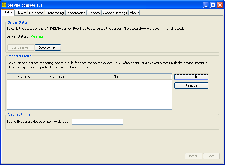

The first problem I have is that the player doesn't appear to show up in the serviio console render profiles / connected devices section.
At the moment I have a mkv file playing via dnla and nothing appears to show up as a connected device.
I have attached a screenshot of the serviio console.

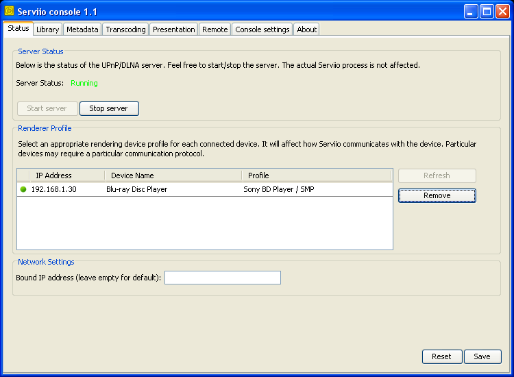

I seem to have fixed my first problem.
A restart of my PC and Serviio as a result now shows the correct connected devices.
