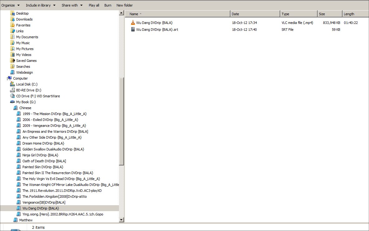

Re: Subtitles, why it works on PS3MediaServer & not on Servi
In attachment the log and pictures
Hope this helps
Anyway you can try out Universal Media Server http://www.universalmediaserver.com/
Hope this helps
