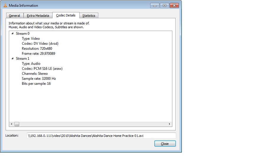

I have Serviio installed on my DS411 and I have lots of AVI files created from miniDV camcorder. I am using PS3 to stream that to feed Denon 2112CI. It plays some of the movies directly downloaded from intrernet but does not play the miniDV avi. Also it does not play the videos created by cellphone (.3gp). I have attached the formats for both of them. Please advise what should I do?
AVI File
ffmpeg version 0.9-Serviio, Copyright (c) 2000-2011 the FFmpeg developers
built on Dec 19 2011 01:36:11 with gcc 4.2.3
configuration: --arch=arm --enable-armv5te --prefix=/opt --extra-cflags=-I/opt
/include --extra-ldflags=-L/tmp/lib --enable-static --disable-shared --disable-f
fplay --disable-ffserver --enable-pthreads --enable-libmp3lame --enable-librtmp
--extra-version=Serviio
libavutil 51. 32. 0 / 51. 32. 0
libavcodec 53. 42. 0 / 53. 42. 0
libavformat 53. 24. 0 / 53. 24. 0
libavdevice 53. 4. 0 / 53. 4. 0
libavfilter 2. 53. 0 / 2. 53. 0
libswscale 2. 1. 0 / 2. 1. 0
Input #0, avi, from '/volume1/video/2007/Akshita IAOGH 2007 Practice.avi':
Duration: 00:09:06.84, start: 0.000000, bitrate: 30412 kb/s
Stream #0:0: Video: dvvideo (dvsd / 0x64737664), yuv411p, 720x480 [SAR 8:9 D
AR 4:3], 29.97 fps, 29.97 tbr, 29.97 tbn, 29.97 tbc
Stream #0:1: Audio: pcm_s16le ([1][0][0][0] / 0x0001), 48000 Hz, 2 channels,
s16, 1536 kb/s

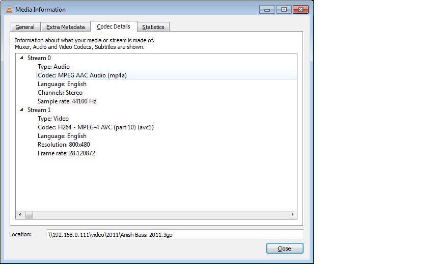

.3gp File
[mov,mp4,m4a,3gp,3g2,mj2 @ 0xf49ab0] multiple edit list entries, a/v desync migh
t occur, patch welcome
Seems stream 1 codec frame rate differs from container frame rate: 180000.00 (18
0000/1) -> 30.08 (361/12)
Input #0, mov,mp4,m4a,3gp,3g2,mj2, from '/volume1/video/2011/Anish Bassi 2011.3g
p':
major_brand : 3gp4
minor_version : 0
compatible_brands: isom3gp4
creation_time : 1945-11-28 04:37:13
Duration: 00:01:50.14, start: 0.000000, bitrate: 3262 kb/s
Stream #0:0(eng): Audio: aac (mp4a / 0x6134706D), 44100 Hz, mono, s16, 63 kb
/s
handler_name : SoundHandle
Stream #0:1(eng): Video: h264 (Baseline) (avc1 / 0x31637661), yuv420p, 800x4
80, 3142 kb/s, SAR 65536:65536 DAR 5:3, 28.12 fps, 30.08 tbr, 90k tbn, 180k tbc
handler_name : VideoHandle
From Sony miniDV camcorder
From Android Cellphone
3gp Format.jpg (73.31 KiB) Viewed 16086 times

ask_j wrote:1. PS3 is not playing avi captured from miniDV (Sony). I already have the line mentioned in my PS3 profile. Its still not playing.
2. PS3 do not play any .3gp files.
3. I have Denon 2112CI, I can see Serviio and browse the folders, but against video folder it says Video(not play) and no matter what you click it does not play that file.
1. Could you provide a miniDV sample
2. Could you provide .3gp information (MediaInfo and ddmpeg -i result), check on detailed logging that ffmpeg don't crash during transcoding.
3. For me Denon does not support video over DLNA :
