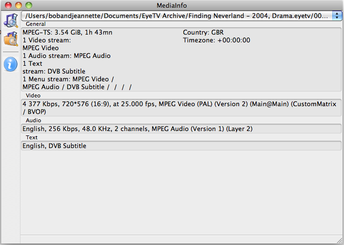

For MediaInfo I'm not sure what I need to send you. Hoping the attached screenshot is what you need.

Also, please select the "text" output format for MediaInfo and post result here, thanks.
