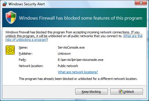

One problem that worries me is this warning:-
Second warning from Firewall.jpg (36.06 KiB) Viewed 23763 times
Notice the comment:-
"THIS PROGRAMME HAS ALREADY BEEN BLOCKED OR UNBLOCKED FOR A DIFFERENT NETWORK LOCATION"
As it points out, I have indeed unblocked this programme before.
If I continue to un-block it at every boot, I will soon have all my ports open to the world!
Can you please tell me why it needs internet access, I cannot see any difference in performance when it is blocked from connecting to the net.
If it is necessary, can I confine it to one specific port??

the reason it asks for access to the internet is to download meta data for your movie and tv files.
Post Thu Jun 02, 2011 8:25 am
Re: Totally lost! help!! KDL40NX803
This is not really asking for opening ports to the internet, it's only asking for the multicast UDP ports and local TCP port for the TV's to connect to. Is it possible that your PC changes IP address every time it boots (changes the whole subnet, not just the last bit of the IP address)

Sorry did not catch the incoming network connections on the warning.

No idea what the answers meant, but thanks anyway for trying to educate me. :mrgreen:
