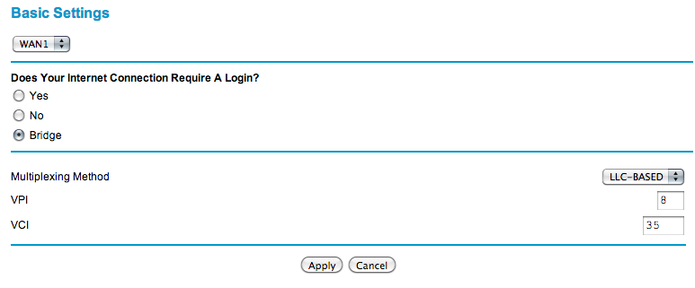

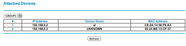

Screen shot 2014-05-07 at 11.26.39.png (20.69 KiB) Viewed 18612 times
Screen shot 2014-05-07 at 11.24.57.png (24.35 KiB) Viewed 18612 times
Ok, so still no luck. Here are the settings of the DVG 1000 that I have connected to my computer and TV.
The computer is al and has the IP address of 192.168.0.2 and I'm guess ing 192.168.0.3 is the TV?
Does the IP address of the other modem that's attached to the internet matter in all of this? Seeing as it's not on the same network it shouldn't be anything to do with this... Correct me if I'm wrong?
Thanks again-

OK, I am still not following something. Is there any connection between the D-Link and the Netgear? If so, then yes they are one the same network and the IP address does matter. They may be different segments, but certainly should be assigned IP addresses within the same subnet.
This is how I think your setup show go, but again I'm making some assumptions here. All devices with an IP address set manually should have a netmask of 255.255.255.0 .
The D-Link should be your primary router for the network. It should have an IP address of 192.168.0.1, and should be assigning IP addresses beginning with 192.168.0.10. You can set the address range in the D-Link DHCP settings. Make sure the correct netmask is being assigned as well.
There should be a Ethernet cable connecting the D-Link to the Netgear. This would plug into the "Internet" port on the Netgear. If this is impossible to do, then the Netgear should wirelessly connect to the D-Link as a bridge (as you appear to have done). The Netgear should have an IP address of 192.168.0.2. Make sure the Netgear has DHCP disabled, although selecting Bridge should do that automatically. Being in Bridge mode should pass everything between the two segments.
All other devices (Mac, TV, etc.) should get their IP address from the network DHCP device, which should be the D-Link. Verify that they have been assigned an address that is 192.168.0.10 or higher.
Why start the address range at .10? This leaves you some room for devices that you might wish to assign an IP address, without interfering with the DHCP range.
From the Mac, you should be able to ping any other device on the network. If the ping fails, then there is a definite issue with your IP addressing and router configurations.
