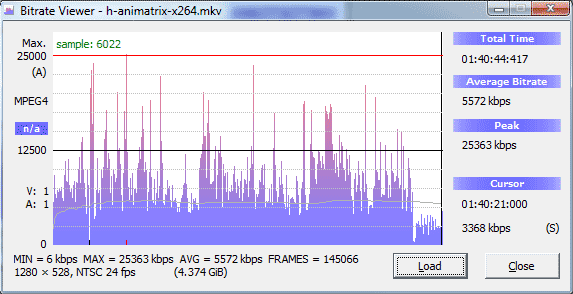

Could you check the average and peak video bitrate of your file with that tool : viewtopic.php?f=17&t=2133 ?

Illico wrote:Could you check the average and peak video bitrate of your file with that tool : viewtopic.php?f=17&t=2133 ?
The average bitarate on this file is 5572 kbps and the highest peak 25363 kbps.
video bitrate screenshot

Post Tue Apr 19, 2011 10:46 am
Re: Sony S570 stuttering - how do I change the socket buffer
Dejavu wrote:This file played nicely today, even over wifi !
Good, but I think you'll have stuttering with such movie, 25Mbps its a very high bitrate for Wifi
