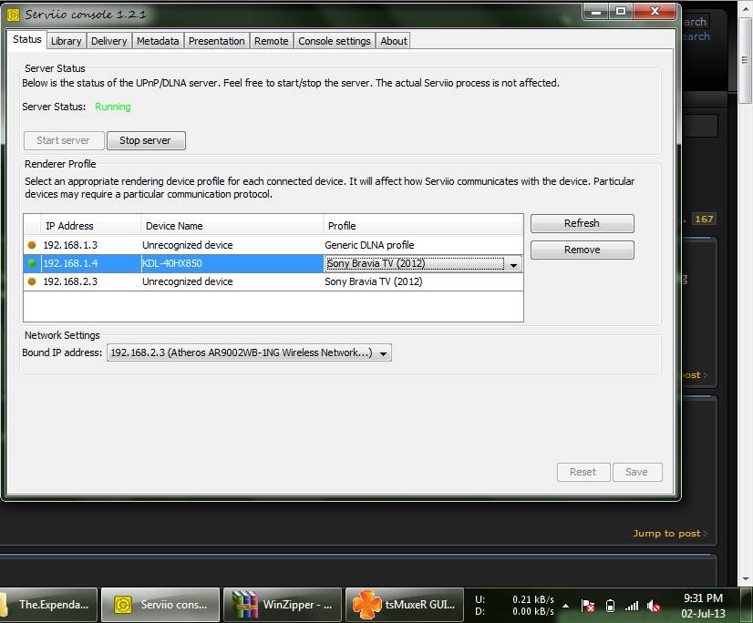

I am new to Serviio.
I want to know how to stream .mkv files to my BRAVIA KDL-40HX850.
I am not getting how to stream files.
My serviio console looks like the one i have sent in an image.
Kindly Help..!

Your settings seems good.
Do you see mkv files when you browse on Sony Video menu?
Do you have only problem with mkv files ? could you play vob, avi or other video file ?
Do you enable subtitles on serviio console?

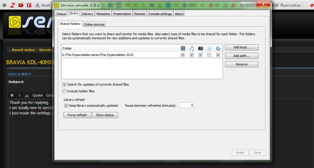

I am totally new to serviio.
I just made the settings, added a .mkv file like the one shown in image.
Now i want to know, What to do so as to try viewing this file in my BRAVIA KDL-40HX850?
I am not getting what to do after adding the .mkv file. Do i need to do something on my TV?

Assuming your tv is connected to your router as your PC is (ie. you have a network). On your tv remote press the HOME button so the tv menu appears on screen. Scroll left or right until you find the 'media' section and then scroll up or down to find 'Video'. If your pc and tv are networked then you'll see Serviio listed (yellow icon), select it then navigate the menus e.g folders, files and then hit play or enter on the file you want.
You'll then be streaming via serviio from your PC to your tv the media file.

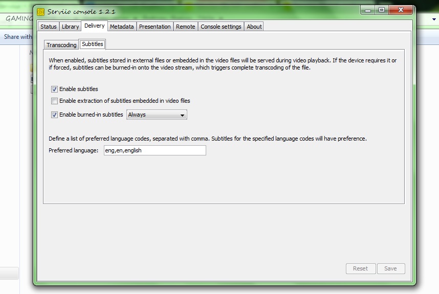

Facing one more issue. and that is with the SUBTITLES.
I am not able to see subtitles.
i made the following settings as in the image.
Moreover, the 'video file' name and the 'subtitle file'' name are the same.
But still i am facing the problem.
My TV also shows a error when i enabled the "burned in subtitles" option.
The error is - "Temporarily cannot access the server. Please try again later."
Kindly help.!
Your reply is valuable.
Post Thu Jul 04, 2013 3:58 pm
Re: BRAVIA KDL-40HX850
post your log, looks like FFmpeg failed

I have Transcoding and subtitles,both enabled.
Do i also need to enable "Burned-in subtitles" ?
Which option to select on it?
nakulchugh
Posts: 12
Joined: Tue Jul 02, 2013 4:04 pm
Post Sat Jul 06, 2013 4:49 pm
Yes it worked somehow.!
Subtitles appeared.
Thank You Guys..! Issues resolved.! :D

I had the same issue.
I checked the option "Enable burned-in subtitles". I think that did the trick.
