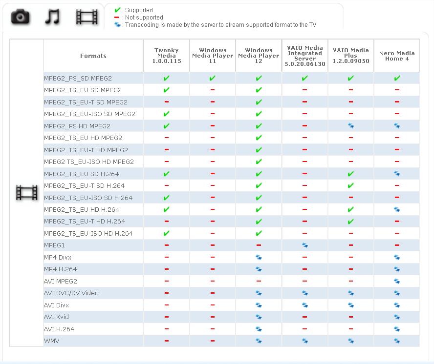

Yes, i think Sony Bravia EX500 and WE5 can stream HD MPEG2-TS file without transcode, for exemple : MPEG2_TS_EU HD H.264
See another source of information for KDL-40WE5 Media compatibility results with DLNA Media servers from support.sony-europe.com

If you can pull this one off, still some hope of getting a single profile for Sony Bravia, unlike the several different profiles for Samsung.
Cheers,
Paul
Post Wed Jul 28, 2010 1:51 pm
Re: Sony Bravia 2009 Series KDL-40WE5
Guys, I wound not recommend using this in the first part of transocingdefinition:
<Matches container="mpegts" /> <!-- if audio different to ac3, mus be transcoded -->
It'll invoke transcoding of all ts files and will therefore create temp files, will take some CPU atc. You should list the audio codecs you want to be transcoded separately, like:
<Matches container="mpegts" aCodec="aac" />
<Matches container="mpegts" aCodec="mp3" /> <!-- this might even work natively? -->
<Matches container="mpegts" aCodec="dca" />
Post Wed Jul 28, 2010 2:16 pm
PaulBravia,
Could you enable debug mode on log file, catch the line of "ffmeg.exe -i" when you start streaming "Iron Man 2", and copy/paste the command here, please?

Post Thu Jul 29, 2010 6:12 am
Hi Ilico, since 'Iron_Man_2-DivXPlusHD.mkv' icon does not appear on Serviio with your sony bravia profile on my KDL-40WE5, I did an ffmpeg -i from cmd prompt instead. This file can be downloaded from http://www.divx.com/en/electronics/solu ... s-hd/video
Does the video appear on your KDL-46EX501 with your profile?
