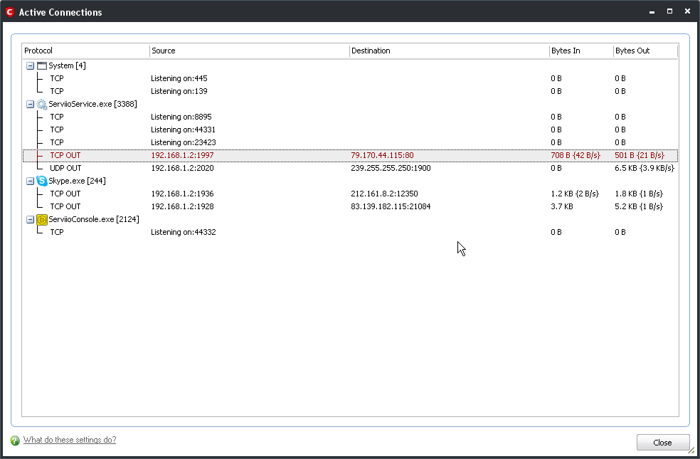

I have some questions which I will ask Sony Tech Support when I am next home during the day. But can anyone tell me what they see when they go into Setting/Network/Renderer/Renderer Access control? All I see is "No devices are currently permitted to access the renderer function. Confirm connections and update the device list."
I am not sure if this is due to no communication from my PC getting out or some Sony bug.
Another question
The TCP port connection 8895 seems to function fine. I did a netstat before starting serviio and then after and I can see that TCP port 8895 opens and is listening after starting serviio.
However for UDP port 1900 I am not so sure about (see attached gif). I have been checking the I/O on ports for Serviio on my Comodo Firewall and I can see that there is never any return for the UDP communication. Should thiere be some returned data?
I have been trying t see where/why any coms are being blocked and
ScreenHunter_01 Oct. 05 19.33.gif (15.01 KiB) Viewed 9984 times
