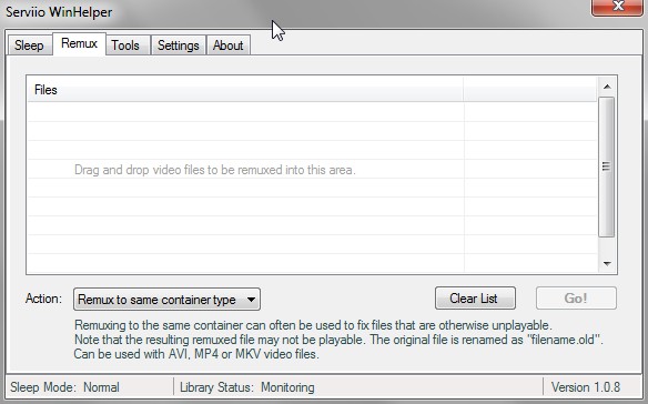

rossomike1966 wrote:I'm trying to play some .mkv file but they don't play...(no sound no video)...here the details...
This MKV/AVC/AC3 should be delivered in native format with 2013/2014 profile, there is probably something in this file that device does not support.
Do you enable subtitles on serviio console ?
Could you provide detailed logging when you start to play such files ?
I suggest to remux your mkv file with this tools.
Tools : Remux to the same container type
Remux_to_same_container type.jpg (47.21 KiB) Viewed 36814 times
