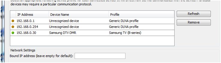

When I start everything my Samsung TV (B) is well recognized as it is with the correct profile (#2) and srt subtitles are visible.

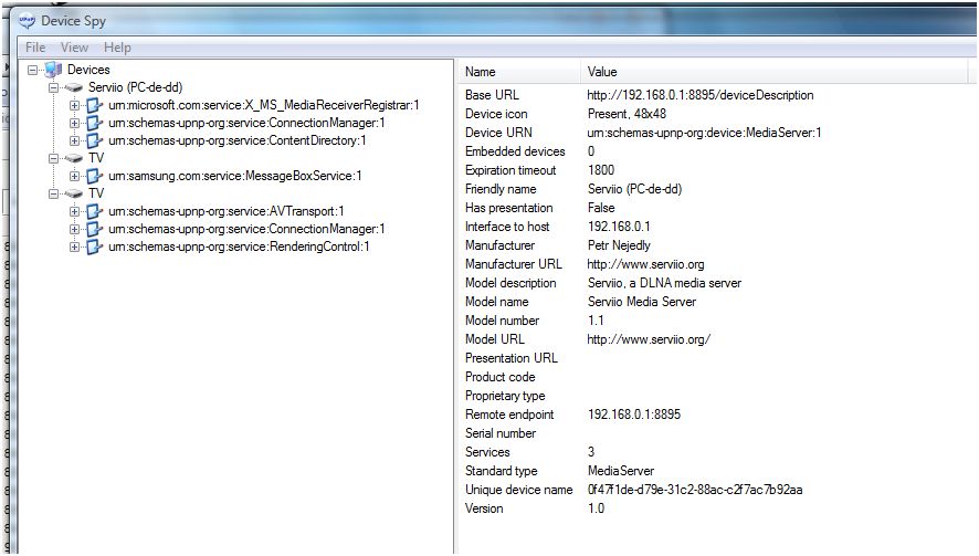

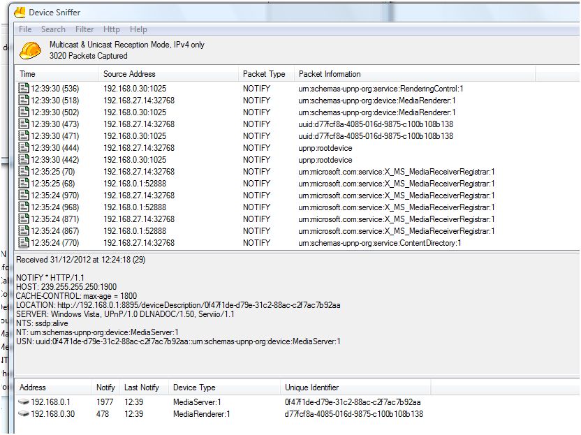

Both TV and servioo are well recognized (see DeviceSpy snapshot).

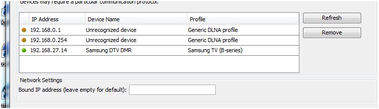

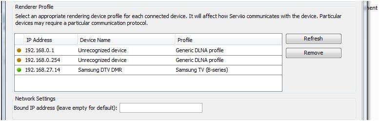

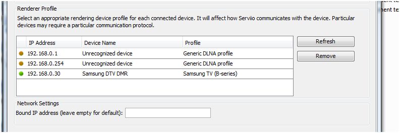

In fact the TV is correctly identified as 192.168.0.30 Samsung ... for 4 minutes : please look at both Serviio Console captures and you could see that after 4 minutes (more or less) the console does not see anymore 192.168.0.30 but the ADSL router address (192.168.27.14). The current streaming works well (with subtitles) but if a swith to another video it is not OK anymore.
This confusion appears when the serviio server refreshes something as the packets tracer indicates it.
If at this point I act on the address 192.168.27.14 (for example "disabling it" in the serviio console), the current streaming stops (of course) but if I start a new video (before the 4 minutes limit ) the TV is well recognized again under its own actual IP address (192.168.0.30) with subtitles. 4 minutes later this correct state vanishes and the wrong IP address appears again in the serviio console.
So the issue IS NOT ABOUT SUBTITLES but about IP addresses confusion at refresh time (every 4 minutes) assigning a bad generic profile instead of the correct #2 one (Samsung B).

why is the router on a different subnet? It obviously gives the TV 2 different IP addresses, one recognizes the right profile, then a second request comes with the same device id but different IP and it updates the IP to this new one. When you request a file on the TV it uses the original IP but it's not found in the list of the devices anymore and thus assigns it the generic profile.
Might also be a setting on the router.

First Servioo console capture : TV recognized as 192.168.0.30
After this initial phase nothing move on the LAN
Then around 4 minutes later, packets are exchanged
Serviio console refresh
Second Servioo console capture : TV recognized as 192.168.27.14

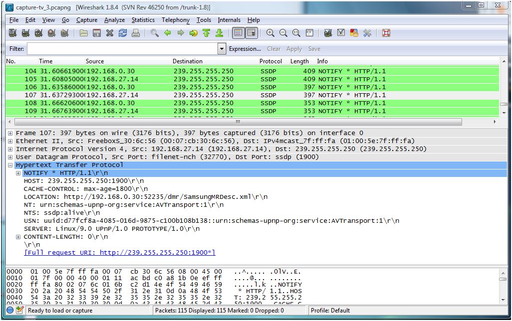

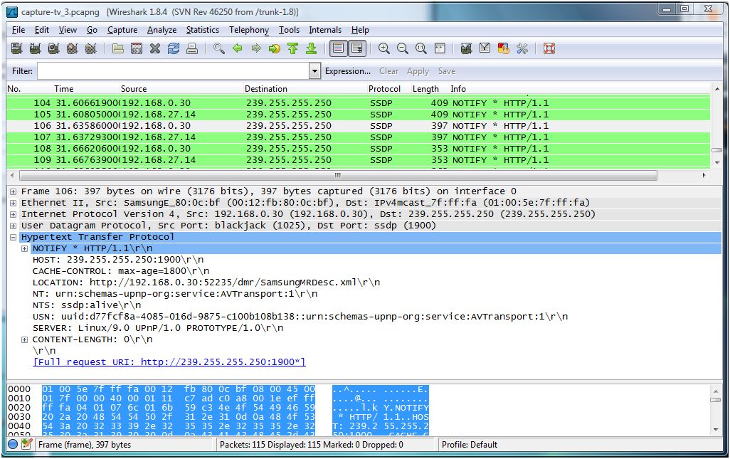

I just restarted a Wireshark capture.
The TV was running : the uuid of the DLNA service is d77fcf8a ...
Just have a look on the two following screen captures of Wireshark:
1) a SSDP packet is sent from 192.168.0.30 (the TV) giving the uuid of its service
2) just after you see the same packet resent by the router 192.168.27.14. Of course inside the packet the "LOCATION" field is correctly giving the owner of the service ...
But let's suppose (it's just a supposition) that rather than using this LOCATION parameter for identifying the sender you used the Src info, then rather than attributing the service to the TV you attribute it to ... the router.
Of course on LAN without router this issue cannot appear. However such "boxes" are frequent on users LAN.
Do you have a different packet routing policy with other ADSL routers ?
I join her the two snapshot and I try in the next post to send the pcapng file in a ZIP.

Post Thu Jan 17, 2013 3:04 pm
Re: Samsung B Series does not display srt subtitles
Thanks for this, it's useful.
Yes, this will be the problem. I also have a router (as most of people at home), but am not getting this behaviour (no incoming requests with the router IP). Perhaps it's a setting on the router, or a part of some network service on it?
