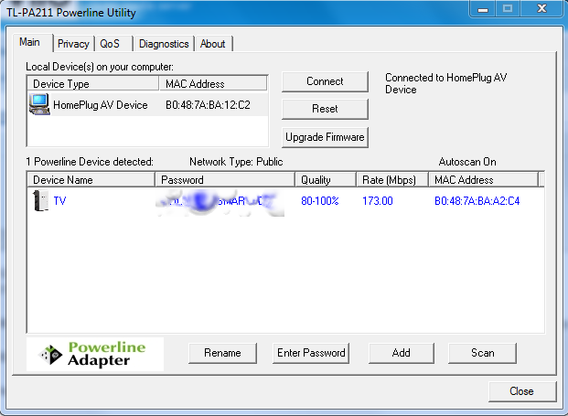

PS. I am not using WiFi, I am using a 200Mbps TP-Link powerline network which I can use to play MKV's of blu rays without any problems so I don't think the newtwork is the issue.

TP-link 200Mbps powerline performance.
