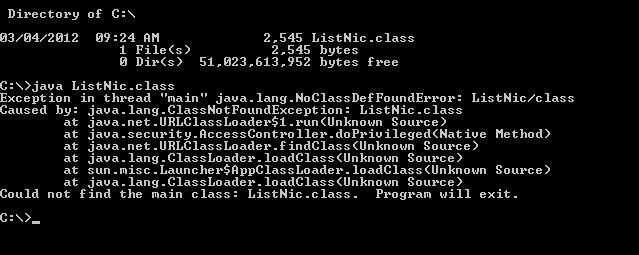

Can you follow the steps in this thread? http://forum.serviio.org/viewtopic.php?f=3&t=3923#p26629 and post the results in that post. This will help Zip get serviio to be better at autobinding.
After you so the steps in that post, do the following to get serviio to work.
In the serviio console place 192.168.1.10 in the bound IP box on the profile selection tab.
Re: Problems with Samsung 6300C connecting to Serviio
See attachment. Once I had my to the bound section, it appears to be working. I'm not sure I ran the listnic.class correctly. The screenshot should tell you. Thanks for the help.
