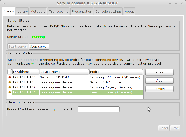

It seems that Serviio with the D series allshare will keep DHCP settings which are outdated in the database and not remove them automatically. Seems that D series firmware does not send a renderer friendly name so what happens to me is that I get more than one profile DHCP address saved in the consoles renderer profiles.
Screenshot-Serviio console 0.6.1-SNAPSHOT.png (61.31 KiB) Viewed 28019 times
My solution was to manually assign a setting other than generic to the address that the renderer currently has. As you can see the addresses 192.168.1.102 and 192.168.1.104 are from the same device...my series D allshare bd player.
Cerberus is absolutely correct. Setting a manual permanent assigned address for the specific device is the best solution, as I suspect the device identification method used by series D allshares is the problem. I have no problem at all with the series C tv as you can see ...it is properly identified by Serviio, Serviio will recognize it and use the right profile for it because it is recognized as a Samsung DTV DMR and receives the correct profile for the device.
With most routers it is possible to set aside some of the DHCP 192.168.X.XXX.X addresses and assign them to specific devices if your router supports DLNA device recognition like mine does. In fact some routers primary dhcp address show up in Serviio console..as mine does here as 192.168.1.101 the default address for my linksys n wireless. I can set my router the way Cerberus suggests and it is fairly easy. So if your wireless router shows up in the Serviio console as a DLNA capable device I am certain that you can easily accomplish the changes.
Even if the device does not have a friendly dlna name it is still possible to find the mac address of the Samsung device ...it should show up as a device somewhere, including the router network interface...... regardless... If all else fails there should be a sticker on the tv or player!
Hope this helps

we need a detailed log of the server starting. It should show Http headers the player uses when talking to Serviio and we can then add those to the profile for automatic detection.

It's this:
2011-12-15 04:40:34,220 DEBUG [RendererManager] Looking for a renderer profile for Http headers: [HOST: 192.168.1.101:8895,USER-AGENT: SEC_HHP_[BD]D5300/1.0,ACCEPT-LANGUAGE: en-us]
Btw, as you're on 0.6.1, make sure this IP address doesn't have generic profile assigned to it in the console.
Post Thu Dec 15, 2011 2:25 pm
Re: Serviio disconnects after a few minutes
looks like you'll have to update the C/D profile user agent detection to this:
(.*SEC_HHP_BD-[CD].*)|(.*SEC_HHP_\[(HT|BD)\][CD].*)
