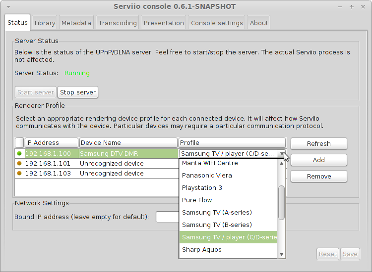

Are you sure that serviio is setting more than just a generic dlna profile...I had the same problem...resetting the console to the correct profile corrected the situation. Have a look at the gui....if it says generic dlna then that is what has happened and you will have to reset to c/d series samsung like I did.
corrected console profile choice for c/d allshare
Screenshot-Serviio console 0.6.1-SNAPSHOT.png (68.45 KiB) Viewed 6309 times
