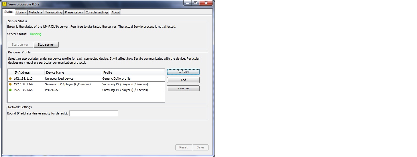

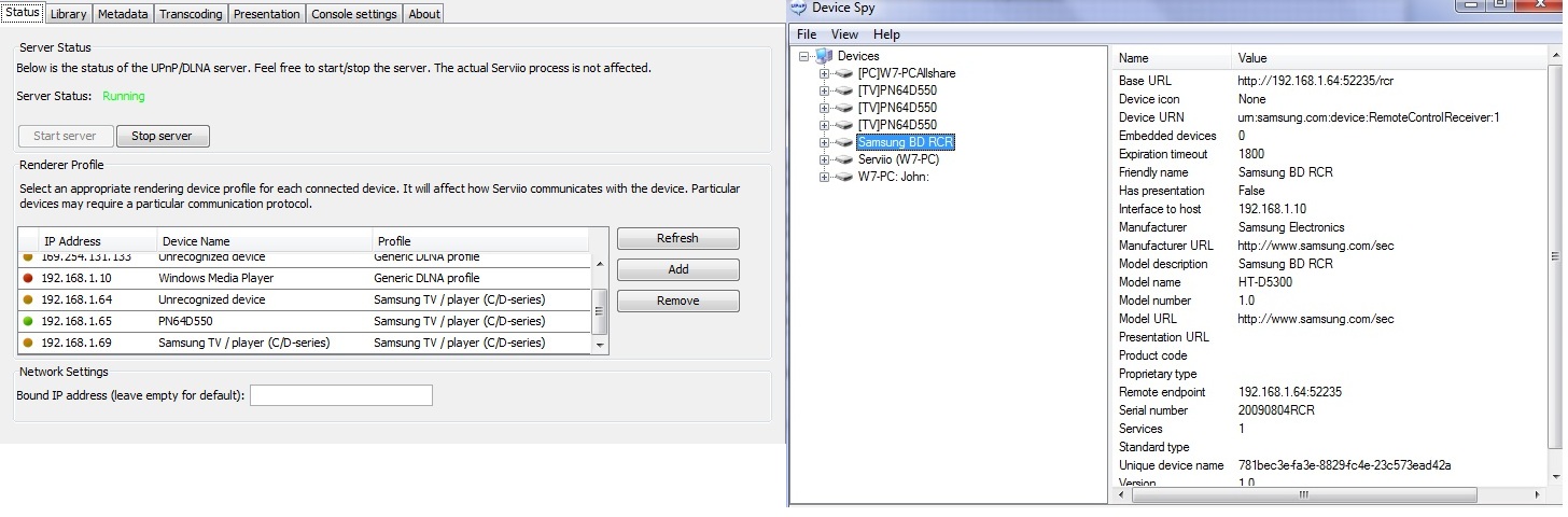

OK. I got it working but this is really weird. Serviio is detecting 2 devices for the combo, 64 which is the correct one but is displayed as unrecognized device and 69 which displays as Samsung TV/player C/D but does not exist either in DeviceSpy or Windows Network Device list!
I had assumed that the detected 69 which points at the Samsung C/D profile was correct, so I did not provide a profile for 64 and so the generic profile was used with no subs. Once I gave 64 the correct profile the subs display correctly.
But the question is how did serviio detect a non existant 69? I've attached a pic of the console and Device Spy. The only thing I have set manually is the profile for 64. The 69 line was generated by serviio using the profile above which we developed earlier ..see viewtopic.php?f=5&t=2712 Based on that the 64 line should have generated the results shown in the 69 line. Perhaps this is a bug?

the RCR device is not the Renderer device but Remote Control Receiver device. Not sure why it's on a different IP but it's not the player itself. The Samsung BD players don't show in DeviceSpy. Make sure you have the device on static IP and set the right profile to the IP. 0.6 will have updated detection for your device.

But subs only display if I set the Samsung Profile on the RCR 64. This doesn't jibe with what you just said.
