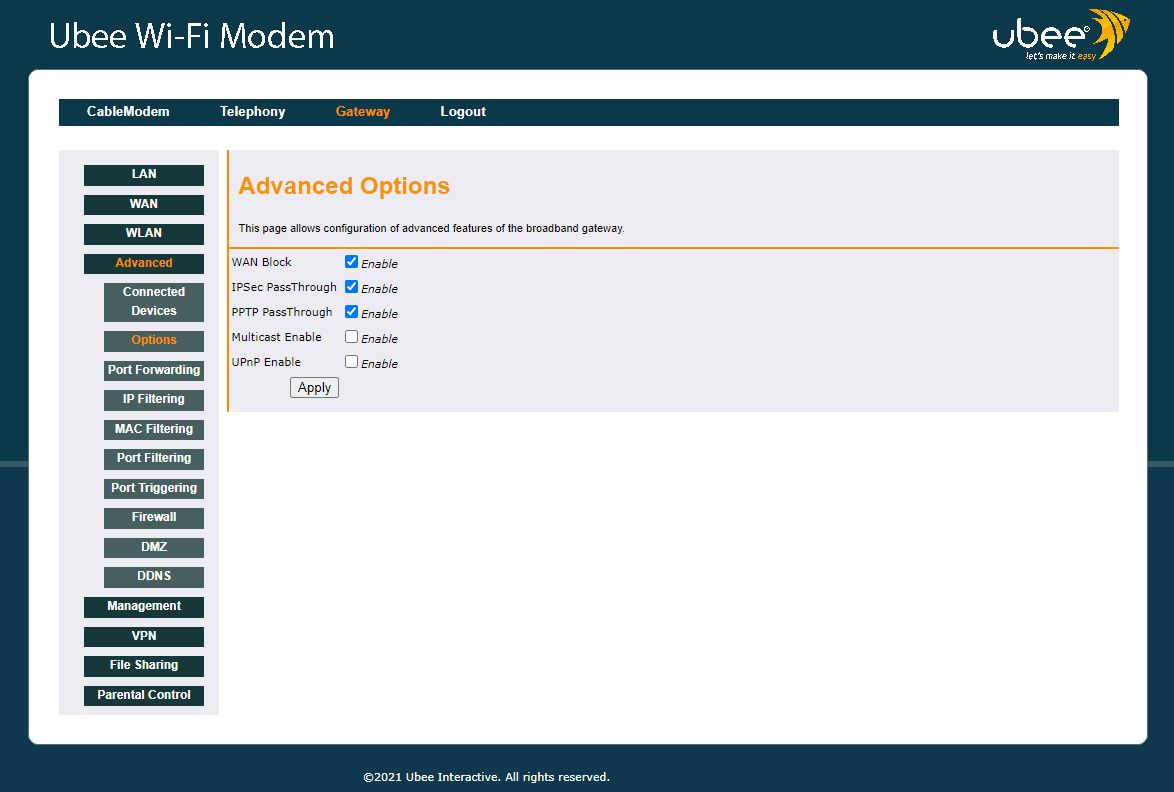

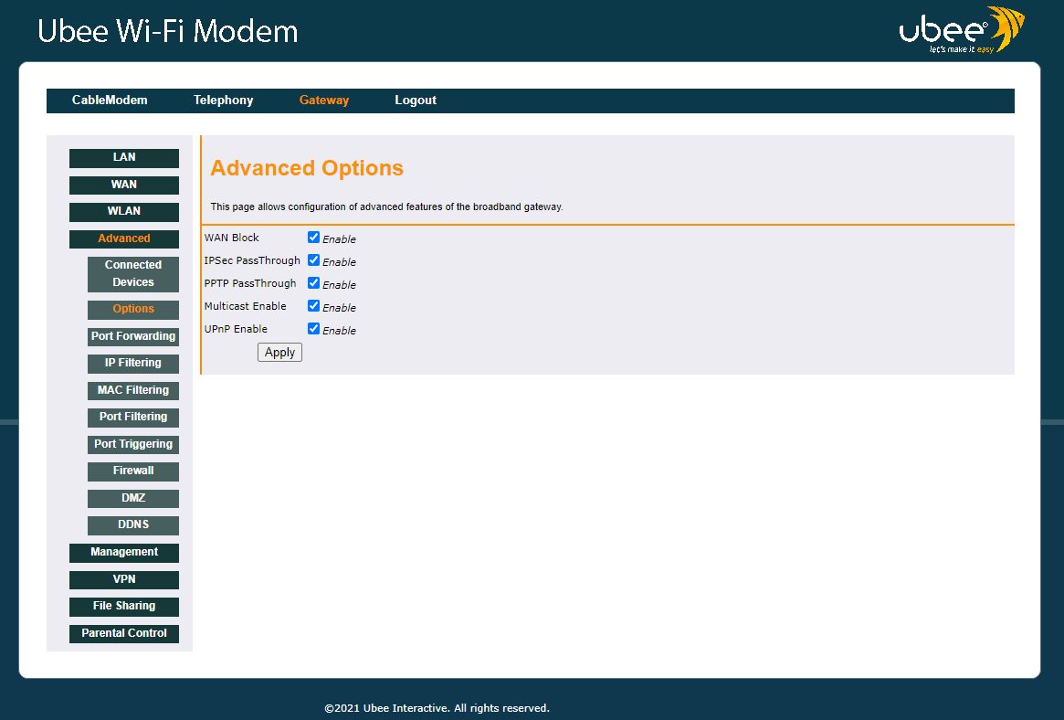

Browsing through the Forum, I've found that this may be connected to Multicast/IGMP settings on the router. The only options I see on my router interface are "Multicast enable" and "UPnP ENable" and by default, the both were on. When I switch them off, the issue persists, only in that case the break comes after about 5 minutes, instead of the 2 or 3 with the features on.

Router settings with MC off
Router settings with MC on
