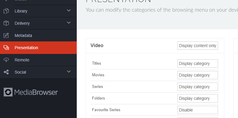

Titles is a default setting, so it should be shown in the Video section. Your console settings should look like the picture I'm attaching.
Double-check your profile setting. From the sound of it, the TV isn't telling Serviio correctly what it is capable of playing, so Serviio isn't displaying it. I have some files that a Roku cannot play without transcoding, and if the wrong profile is selected, they won't appear. Since you've done a clean install, you should be able to access the MediaBrowser and see if they appear there. If they do, then the problem is the communication between your TV and Serviio.
If the correct profile IS selected, then try some others. Generic transcodes nothing, and since the Samsung sets don't seem to work well with transcoded files you aren't missing anything. The DirecTV profile transcodes everything, so with that one most likely nothing will play. My wife is using our JU7100, so I can't test with it right now.

I thought that was what you were talking about regarding the titles folder. That is what I am using. I have tried the default settings as well as the show content only settings. Still get the error "NO CONTENT FOUND"
I tried Generic profile as well as different other ones no difference. I am using the Samsung J series which was working and also showed all those files.
