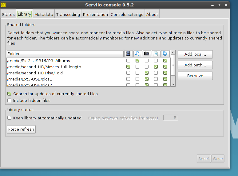

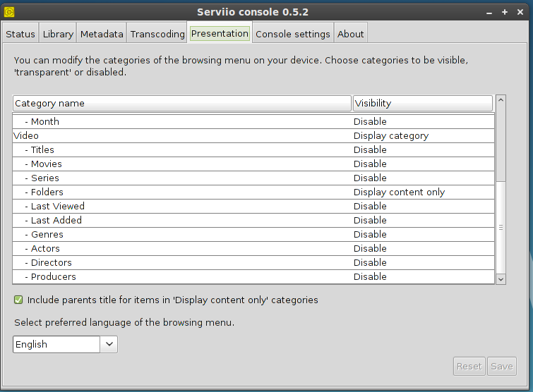

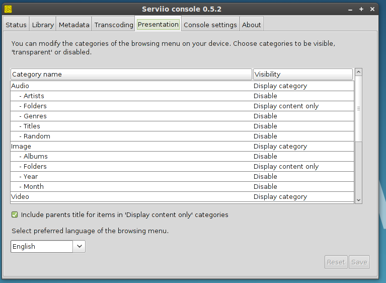

To answer zip's question, whenever I select "Video" from the main menu, a new screen appears with three folders, called Video, Images, and Music but only the contents of the Video folder are able to be accessed. If I want to access the Music folder, I have to choose Music from the main menu instead of Video. Likewise for Images. All versions of Serviio work this way and I haven't found that to be a problem.
To answer cerberus's question, I have attached my presentation and library screens.

ok only different between mine and your is the show parent catagory tick box try unselecting that and try again. :)

I un-ticked the parent directory setting but the results are still the same. I can not return to the starting screen unless I exit Serviio and start it back again.
