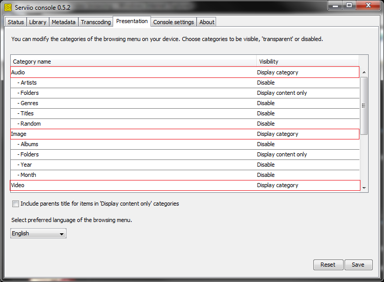

ALL the ones with the RED border musst be exactly as in my image or it will not work. They must be set to " Display Category " the rest can be set to what ever you want. :)

thanks, now it works right.

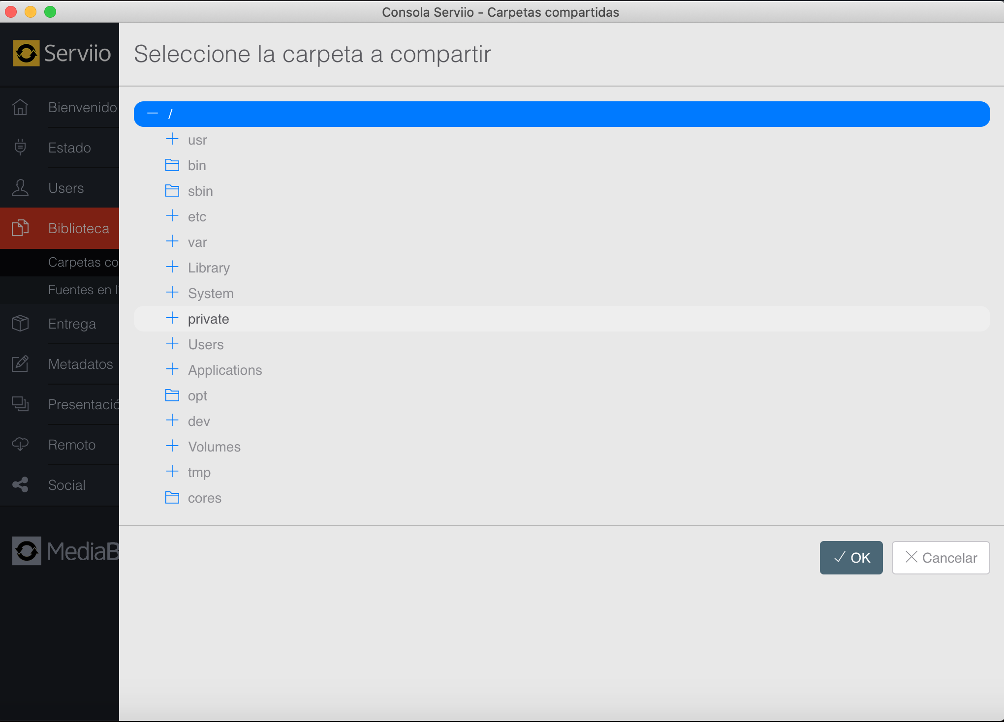

Hi, i dont know if anyone of u speak spanish, but i will try explain my problem.
I cant select the folder i want to share in the software because i cant find the correct folder.
I use a Mac, and the folders that appear i guess are of system or something like that.
