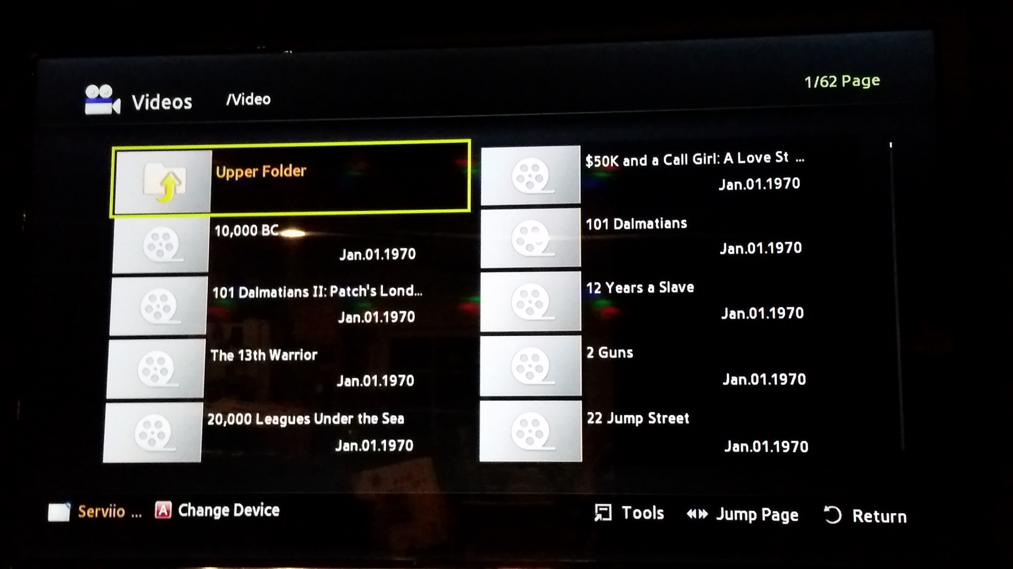

Post Sat Jan 03, 2015 3:56 am
Re: F5700 dates set to 01/01/1970
Here is pic
Post Sat Jan 03, 2015 4:49 am
Yep, that's what my H series BD looks like too. The HU8550 TV has dates all over the place, some like this and some 100 years in the future :o . Not a clue where Samsung is getting the information.
