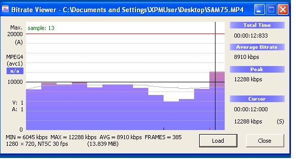

Post Wed Feb 16, 2011 6:50 pm
Re: Problem with mp4 files on Samsung C6540
Bitrate Image attached
Post Thu Feb 17, 2011 7:52 am
Ok peak video bitrate 12288Kbps is not too high
