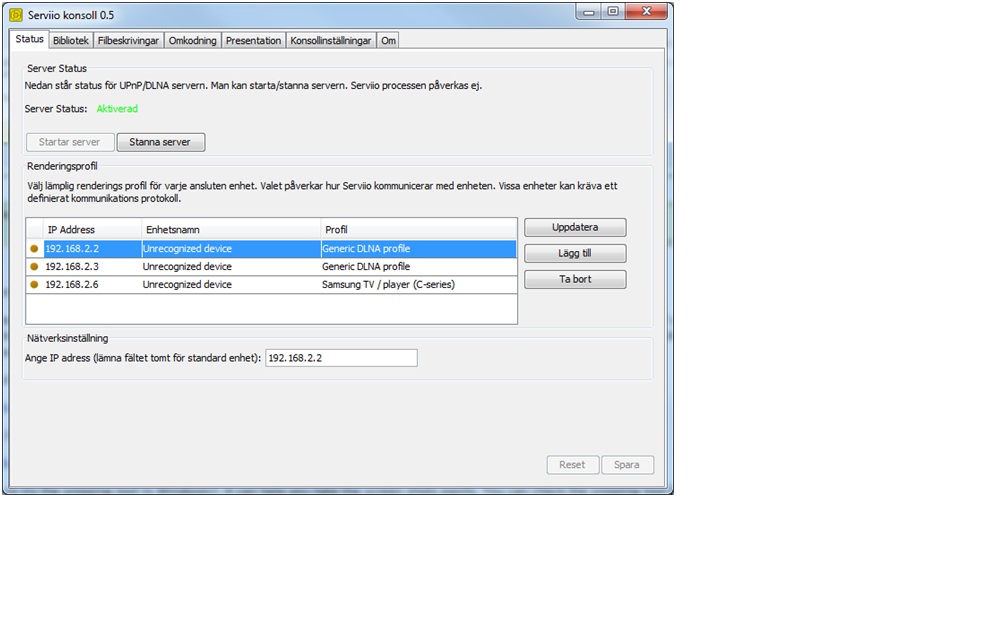

I have problem connecting my PC to Samsung BD C6900. The problem is that Samsung BD C6900 don't show my PC, serviio show the ip number and find samsung but something strange is that all devices has yellow dot. What could be the reason of this? Just notice is that sometimes the samsung find PC, but most of the time I can't see my device in the blueray.
My network is one PC and one laptop, both connected wireless to router and samsung BD C6900 connected with cabel to the router. Serviio is only installed on the PC. Sorry about swedish language in attachment.

Is 192.168.2.2 the IP of the PC? Make sure the PC (and Bluray) have static IP addresses setup on your router so that it stays the same.
Orange dot is ok, just means that the status of the player cannot be retrieved (on/off) as it doesn't support this functionality.

Thanks for the quick respons zip. That correct PC is 192.168.2.2, Laptop is 192.168.2.3 and Blueray is 192.168.2.6, all are added as static ip adresses in router from there Mac Adresses. And still problem with finding pc in bluray.
