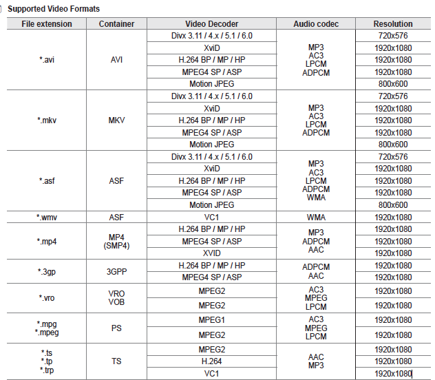

My TV is a Samsung LE46B650 television.
I'm using the Samsung B Series profile, and as far as I can see it should be fully capable of transcoding DTS?
Skærmbillede 2014-08-07 kl. 20.14.09.png (87.34 KiB) Viewed 5297 times
I'm trying to play a MKV video, but do only get picture - no Audio

Re: Missing audio on Samsung B series
DTS is not supported by the B series. Thus the Samsung B profile transcodes it to AC3. make sure you have this profile selected and transcoding on.
