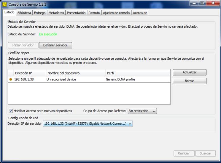

What does this mean: does not have access to the server
In status console name device show: unrecognized device
in profle: Generic DLNA profile
Bluray BD-F5100 not is recognized for serviio?

Check the device in the console's status tab and make sure it's enabled (ie it has access to the server)

thanks for answering.
Console show: image001.jpg

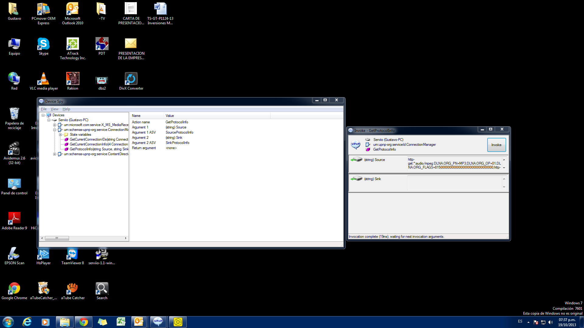

Upnp show: image002.png
Why not recognize the device by Serviio or why not shown in "device spy" my bluray?
The main problem is that when playing a video in bluray stays loading and then appears that the format is not recognized.
Or it plays the video but too slow.

Please post detailed log of when you play a file that fails.
